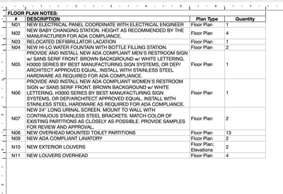

Example 1: ( see screenshots below)

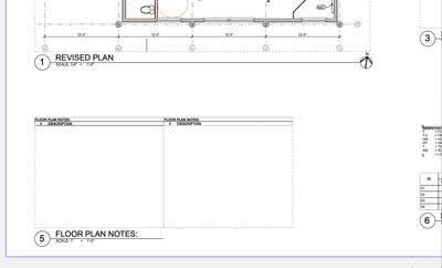

When I Update the whole set so that I can publish afterward; The Floor Plan Notes (schedule) in my Layout will only show the header and all the entries are missing but for some reason the door/window schedules on the same layout update fine. If I open the view of the Floor Plan Notes schedule, and update, most of the time it goes back to normal on the layout, other times it takes multiple attempts. Having to comb through the set to verify all my schedules are showing up correctly, and manually update the individual schedules that got messed up each time is really annoying, prone to human error, and not very BIMinimalistic; especially since sometimes it doesn’t happen so I think the problem has been solved; I update, publish, send the set, and end up looking like a fool when stuff is missing. ,
This image shows the schedule with all the items missing on the layout after updating the setThis image shows the schedule with all the items missing on the layout after updating the set
This image shows the Schedule when I click "Open Source View" showing how the items are not really missing in the view.This image shows the Schedule when I click "Open Source View" showing how the items are not really missing in the view.

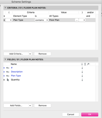

This image shows the schedule's Scheme settings; In the criteria all I have is a simple "Option Set" property where I select in which of these views the scheduled elements will show up in. This way I don't have to worry about layers or element types.     In the "Fields" I have Two string properties to add the keynote and the description, and the last two are there just to help me organize things and modify where I want the elements to show up, but those fields get cropped in the layout.This image shows the schedule's Scheme settings; In the criteria all I have is a simple "Option Set" property where I select in which of these views the scheduled elements will show up in. This way I don't have to worry about layers or element types. In the "Fields" I have Two string properties to add the keynote and the description, and the last two are there just to help me organize things and modify where I want the elements to show up, but those fields get cropped in the layout.
The properties that I'm scheduling in these examples are taken from a CONTRABIM keynotes video

I just discovered your post after our firm had the same issue. We also noticed that the issue was consistent with having a renovation status (in our case the view settings of the schedules was the issue).
Try right clicking on your schedule in the view map, going to view settings, and changing the renovation status to a known setting that includes whichever renovation statuses you want to include. Also make sure to right click and redefine with current view settings after making the change.
