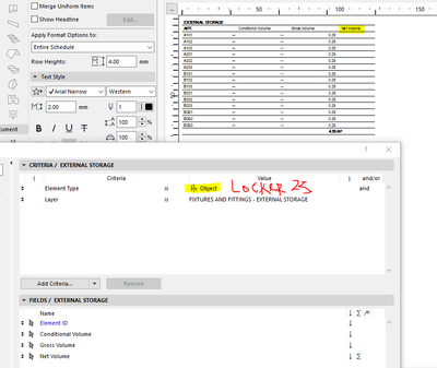

Here is my schedule for the external storage, I'm using Locker 23.

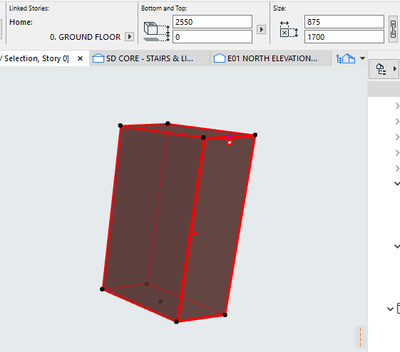

The locker is 1700x875Dx2550H, should be ~3.8m3 brut (without counting the "frame"). I've tested every available volume but the only one working is net: 0.29 with the sum of all of them 4.35m3
Obviously not right. The same happens when I try to do the same for internal storage (wardrobe 23 & Ci cabinet).
Am I missing something? Or is it just that objects can't be scheduled unless GDLed specifically?

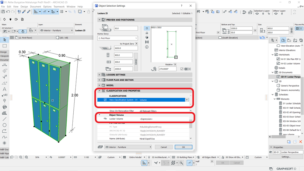

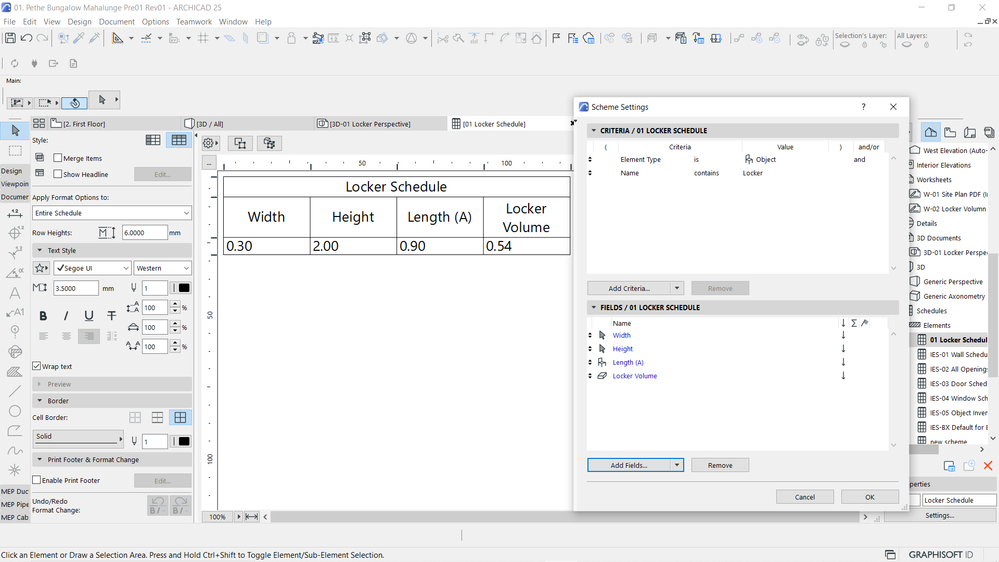

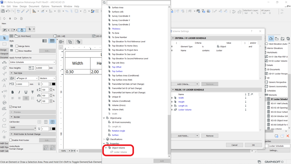

Try to use "Classification & Properties" and define a New Property as shown below
Step 1Step 1Step 2Step 2Step 3Step 3Step 4Step 4

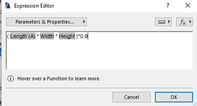

@Rajesh Patil , you're a genius man! I did not even think of creating an expression to do that job. Legend! I'll try that this norning
Vincent G_
So it works perfectly!
To be a bit more accurate, I added "*0.9) in the expression to take into account the locker frame, (-10%).
