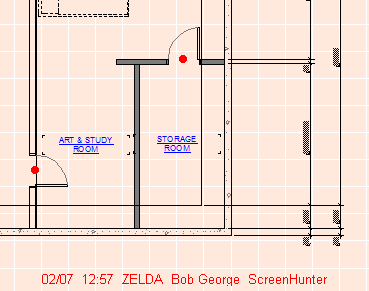

Can somebody tell me what the selection dots in two of the doors in this plan mean? How did they get there, and how do I get rid of them. They just don't go away. Both were placed from my Favorites list.

They appear to indicate a library part that is not loaded. Given that this appears in association with the doors. I would suspect that is it a door label that is not present in your loaded libraries. Take a look at your library report, it should indicate if a used part is not loaded. If that is the case, locate the part and loaded with the library manager.
HTH
Erich
