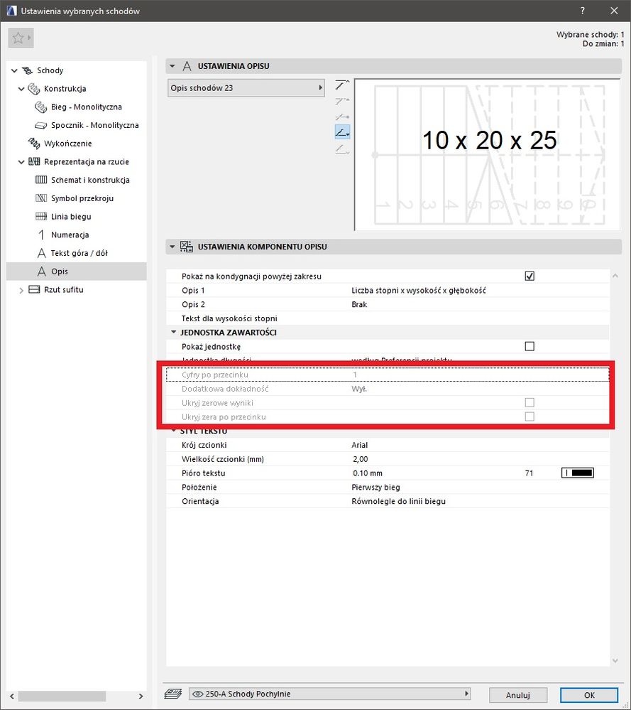

Hello,
I need to set the stair description, so it displays step height with millimeter precision, but these fields are grayed out and I can't change anything. Currently, it shows the description with centimeter presicion, but it's not sufficient.
What should I do?
Sorry for the screenshot in Polish version. And it's AC 23.

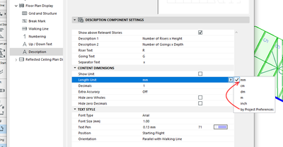

Sorry, my screen shot is English.
Change your 'Length Unit' from 'Project Preferences' to 'mm'.

Cool, that's it, thank you!
I should have spotted that myself...
