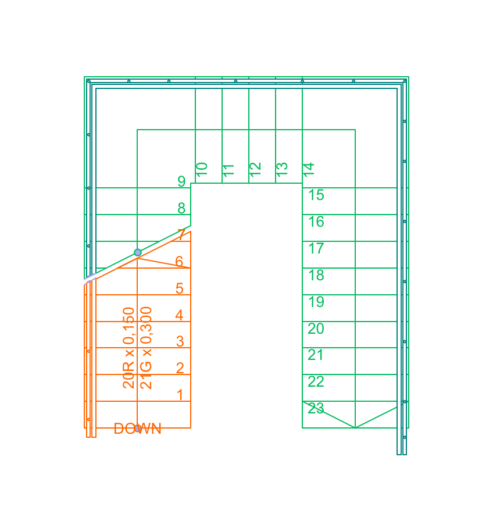

This article outlines the floor plan representation of staircases using the new Stair Tool. We took a U-Shape stair as an example and followed it through 3 stories.
The example in this description is a staircase with a story setting of
  • First Floor 3000
  • Ground floor 4000
  • Basement 2700
The floor plans of the different levels are coloured with specific colours for easier understanding of the plan. Lets look at the basic settings of this floor plan that make for the following representation.

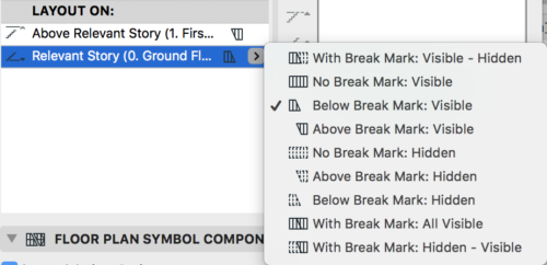

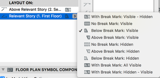

Layout On (Stair Display On Each Story)
Under Layout On: Click on the Story name, then choose how to display the Stair on that story:
  • Break Mark: With or without a Break Mark
  • Visible vs. Hidden Attributes: To use either Visible or Hidden attributes on the displayed parts of the Stair. The set of attributes (for hidden and visible parts) is defined for each symbol component on its own settings page.
Use the Preview to get an idea of the Stair’s 2D display on each story.

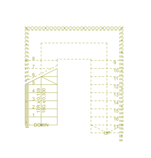

Basement level 2D symbol
Floor Plan Display Layout: Above the relevant (home) story, the stair should be visible. For all the floorplans we have used the "Home and One story up setting". Layout on: On the home story the stair should be visible till the break mark only and represented with hidden line above the break mark.Above the relevant story the stair should be visible only above the break mark. The screenshots show the matching options.
Ground level 2D symbol
Floor Plan Display Layout: Above the relevant (home) story, the stair should be visible. For all the floorplans we have used the "Home and One story up setting". Layout on: On the home story the stair should be visible till the break mark only. Above the relevant story the stair should be visible only above the break mark. The screenshots show the matching options.
1st floor 2D symbol

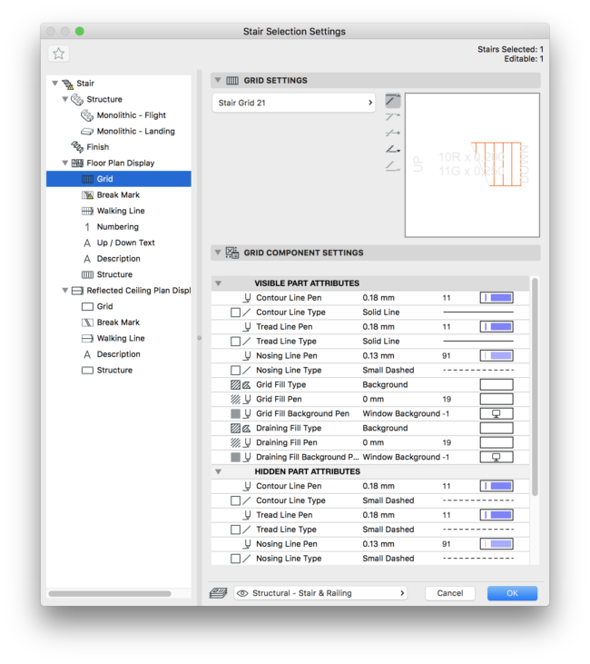

Grid
Choose the Grid component from the pop-up menu and set the Component’s attributes in the bottom panel – separately for the Visible and Hidden parts of the symbol, as applicable.

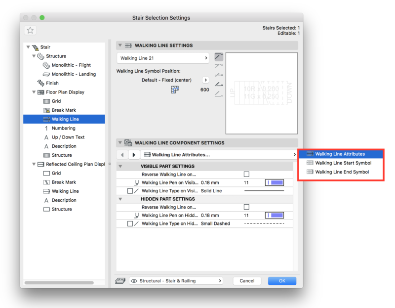

Walking Line Symbol
The walking line attributes and Walking Line Start and End symbols can be adjusted under the tabs.
And the End symbol can be choosen under Walking Tab Component Settings

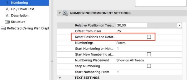

Numbering Symbol
By default, numbering applies to Risers (the “Number Risers” box is checked.) Uncheck this option if you want to number the Treads instead. There are a series of numbering options:
  • the numbering can start on a different tread (or riser) than the first one, this could be advantageous for example on a bullnose stair, where the first two steps are not to be numbered
  • numbering can be displayed on all or every Nth tread (or riser)
  • and can be stopped at a chosen tread (or riser)
Once an element is moved, for example the numbering and the description, the setting window will offer resetting to the original status.

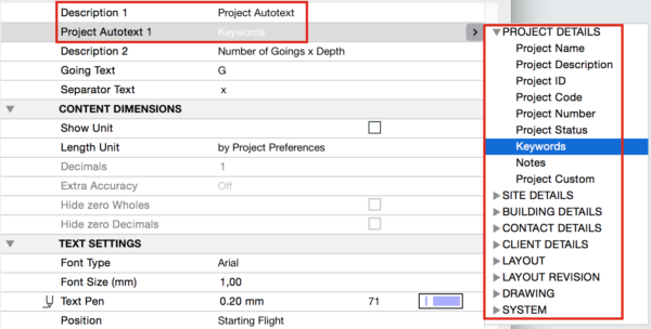

Description
You can edit (move or rotate) the description graphically as well as in the settings, after selecting them in Edit mode (Symbol view). There is a broad range of descriptions to choose from:
  • standard available options
  • custom options
  • autotext or
  • switching the description off completely
The screenshot below shows the autotext option loaded as description.
The measurement units displayed, can also be customized here:

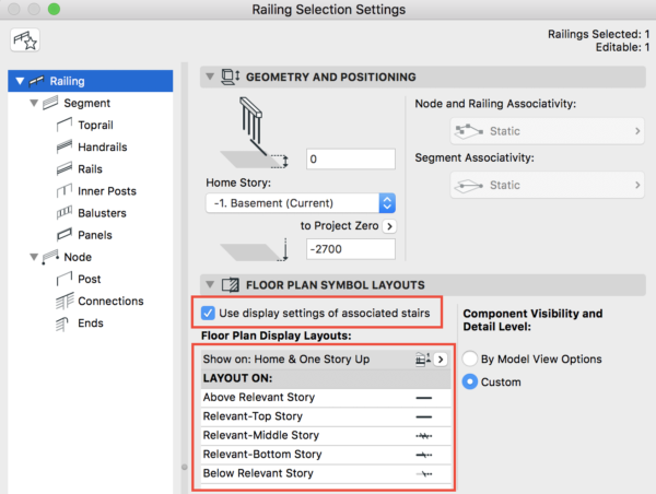

Railing floor plan representation
If the floor plan is set up for the stair, the railing Break Mark can adopt the settings of the associated stair.
If the railing is not associative to the stair or needs to be set up differently, the same options are available under floor plan symbol layouts. Please note, that non-associative railing's cut break mark can be adjusted to fit the stair’s break mark manually, by entering into Edit mode as well!
