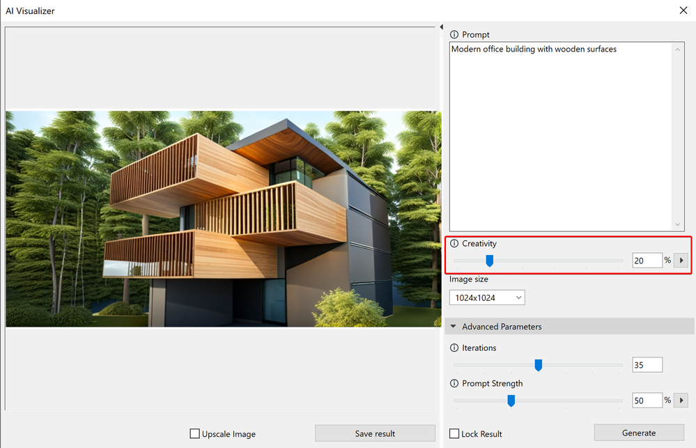

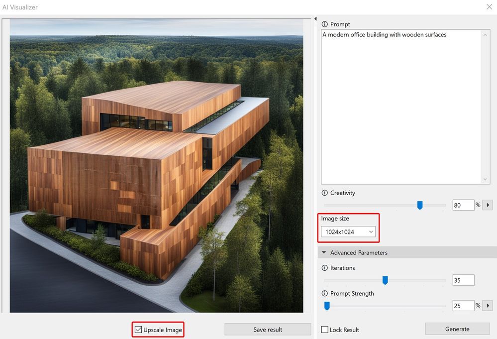

To begin, create a simple mass model in Archicad, which can be as simple as a few blocks representing the major volumes of a proposed building. Once the mass model is ready, you can use text prompts to guide the AI in generating different design alternatives. After running Generate with your prompt, the AI creates an image of the 3D view and begins refining it.
For example, a prompt like "Modern office building with wooden surfaces" could yield an iteration of your mass model, façade aesthetics, or other iterations that could be tried with different materials, each with different aesthetics. For this test, it resulted in the following example:

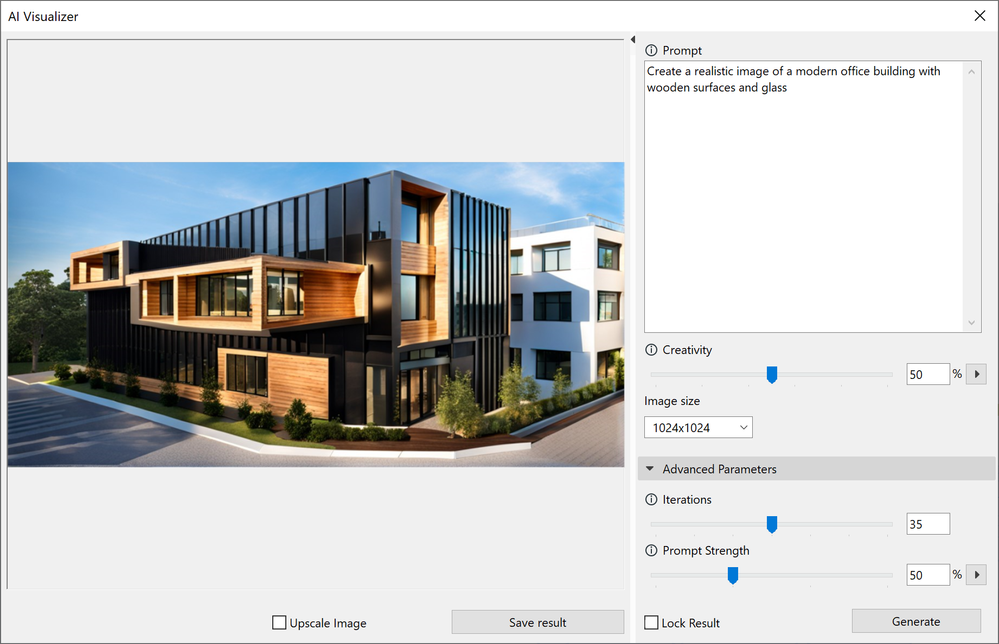

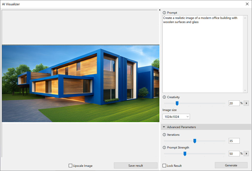

One of the standout features of the AI Visualizer is its ability to generate diverse design variations from a single mass model. By adjusting the Creativity Slider, you can control the degree to which the AI deviates from your original model. Lower settings will produce designs that closely adhere to the mass model’s geometry, while higher settings allow the AI to introduce more creative elements, such as innovative façade patterns, unique structural forms, or unexpected material combinations. For example, here we have a prompt “Create a realistic image of a modern office building with wooden surfaces and glass” and the same prompt is used with different percentages of the creativity slider:
Creativity at 20 percent:
"Create a realistic image of a modern office building with wooden surfaces and glass"

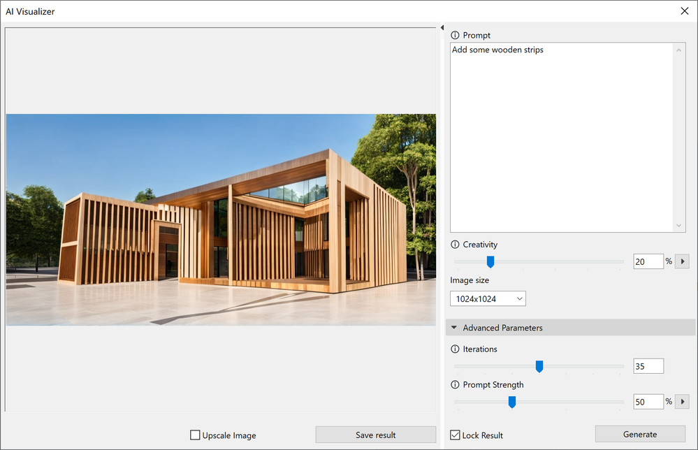

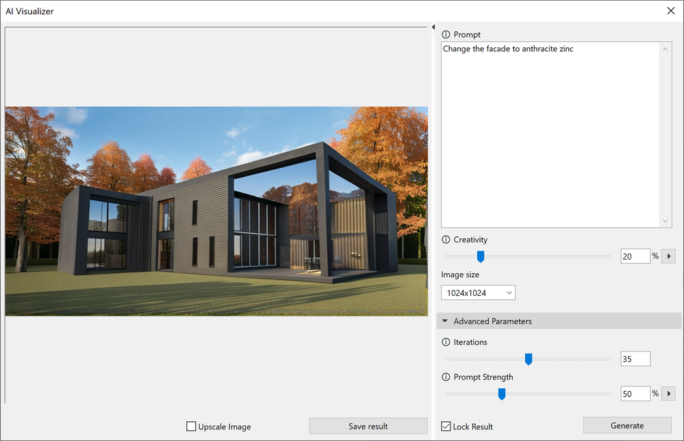

As you explore various design options, the Lock Result feature becomes invaluable. This function allows you to preserve the design that resonates with your vision while continuing to experiment with other aspects. For example, if the AI generates an accurate representation of your idea, you can lock this aspect and explore different configurations for the building’s form or the integration of outdoor spaces, ensuring consistency across multiple iterations. When you have a design you like, the Lock Result feature remembers previous prompts, and you can further customize the image. Here are some examples of this feature: 
Facade Option 1:
"Add some wooden strips"
Facade Option 2:
"Change the facade to anthracite zinc"
This feature is particularly useful during the conceptual phase when presenting different options to clients. You can maintain a consistent design narrative while demonstrating flexibility in other aspects, such as materiality or spatial organization

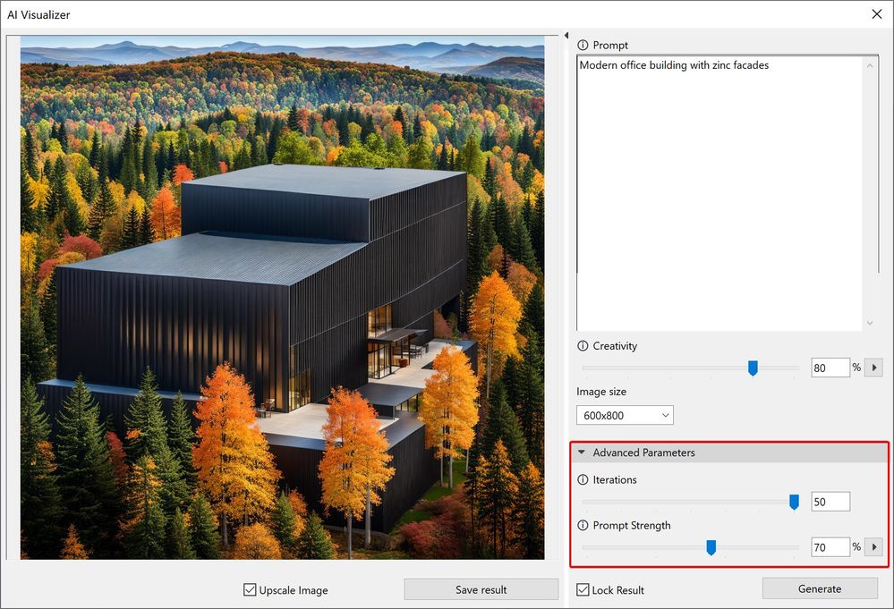

These settings allow for fine-tuning and include Iterations and Prompt Strength They can be used in conjunction with the Lock Result feature.
Iterations:
This controls the number of times the generation process is repeated. A higher number of iterations results in more accurate outputs but takes longer to complete, while fewer iterations are faster but less precise. The default value is set to 35, which provides a good starting point, though you are encouraged to experiment within the range.
Prompt Strength:
This setting determines how closely the AI adheres to the given prompt. A higher prompt strength ensures the AI follows the instructions more strictly, potentially reducing creative flexibility. Lowering this value gives the AI more freedom to be creative. Adjust the prompt strength to find your ideal balance.
Image Size Parameters
This parameter controls the resolution of the generated image, directly affecting the time it takes to produce. Higher resolutions result in better image quality but require more time to generate. The default size is 800x600, with a maximum resolution of 1024x1024 available for use.
Combining this with the Upscale Image will allow you to export your image at a larger scale: the long side will be increased to 4096 pixels,
and the shorter size will be proportional to the original image size. Activate this function before generating the images. If you wish first to generate a lower-resolution image as a test and then upscale it, be sure to turn on Lock Result to preserve your original result. 

  2. Apply Text Prompts: Use descriptive text prompts to guide the AI in generating different design variations. For example, “Create a realistic image of a modern office building with wooden surfaces and glass.”
