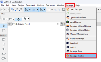

Install Enscape palette

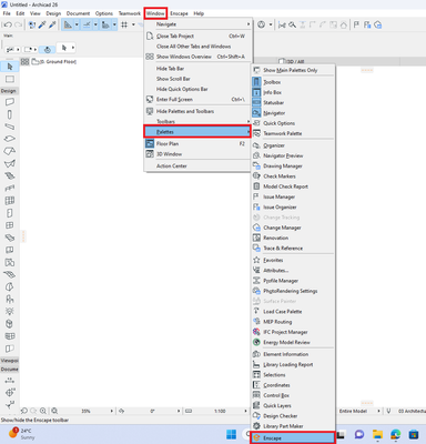

Once the Enscape installer completes its execution and is subsequently closed, you can proceed to launch Archicad. Following this, you should observe Enscape's presence as a toolbar within the Archicad User Interface (UI). When engaging with Enscape within Archicad, the toolbar can be configured to either remain docked or function as a floating window, offering flexible accessibility to its features.
Download enscape here - https://enscape3d.com/archicad-rendering/
Upon successful installation, you can access the Enscape plugin within Archicad by navigating to the "Window Menu," and finally choosing "Palettes." Within this menu, you will find the Enscape Palette within the list.
 Additionally, as part of the default setup, you will notice an "Enscape" menu option located in the top menu of Archicad. Clicking on this menu will unveil a comprehensive array of Enscape options for your convenience.
 To observe your Archicad project in 3D, adhere to the following sequence of steps:
  1. Launch your Archicad project file.
  2. Ensure that you have either a Perspective or Axonometry view open.
  3. Click the "Start Enscape" button found within the Enscape menu, palette, or toolbar.

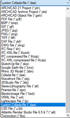

  1. Method B: Lumion.DAE File Export
3.1: It's advisable to utilize LiveSync for faster and resource-efficient model export. However, if you prefer a file-based export, you can create a Lumion Collada file (.DAE) through the Lumion LiveSync for Archicad Export button in the palette:
3.2: Alternatively, you can select "Export as COLLADA file" from the LiveSync menu.
3.3: For users with older versions of the Archicad plug-in, please use the following command:
  • File -> Save as... -> Lumion Collada file (.DAE)
Ensure you choose the correct Lumion Collada file (.DAE) option:
3.4: Import the .DAE file in Lumion, version 5.7.2 or later.

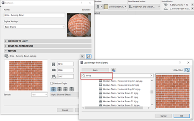

Surfaces and Building Materials play a crucial role in visualization workflows. Architects often use extensive lists of these attributes. Now you can experience an enriched and more efficient workflow with the extended search capabilities available in various pivotal Archicad dialogs. This advancement eradicates the need for laborious scrolling through long lists to locate the required items, ushering in a new era of expedited workflows. Here are some notable instances:
  • Load Image from Library: Effortlessly locate any texture image to apply to a surface.
  • Drawing Manager: Seamlessly search for specific drawings or external documents.
  • Attribute Dialogs and Lists (Folder-Based): Streamline your search across various attribute dialogs and lists organized by folders.
  • Link Drawing: Swiftly pinpoint project views.
  • Graphic Override Combinations and Rules
  • 3D Styles
  • Rendering Scenes (Select and Manage Rendering Scenes)
  • Favorites: The existing search functionality within Favorites has been enhanced; it now waits for additional keystrokes instead of generating previews after each keystroke, avoiding potential slowdowns in lengthy Favorites lists.
  • Incorporating this improved search, simply press the Escape key in any of these search contexts to reset the search term and initiate a fresh search. This update marks a significant stride toward a more intuitive and efficient workflow within Archicad.
