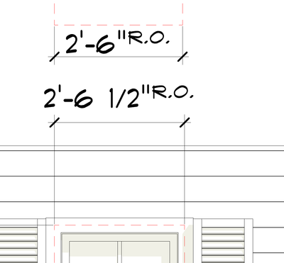

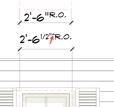

Not a bug perhaps, but still something that does not function as well as it could.
When using the Superscript function, if Dimension settings are set to display Fractions in Small Type the Superscript indicator ( ^ ) will show up in the Dimension.  It does not show up for dimensions with fractions unless the Fractions in Small Type setting it on - which is just about always, when fractional inches are being displayed.

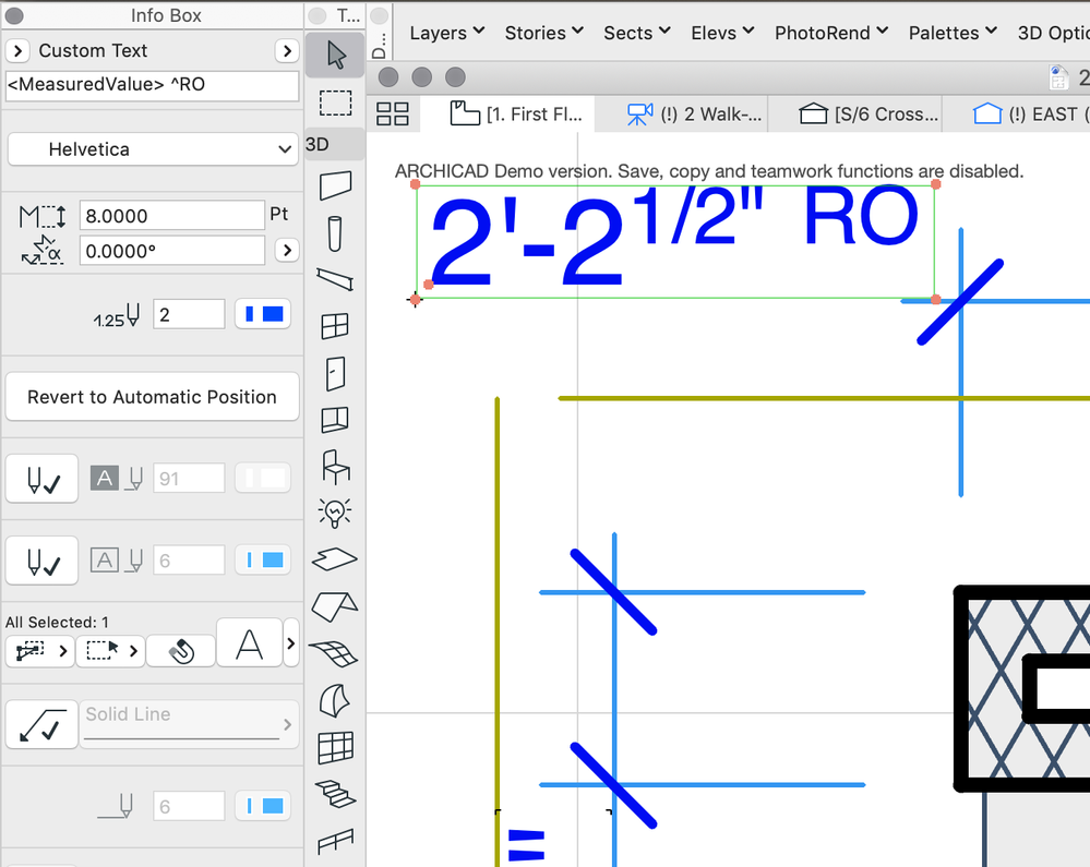

I am seeing the same thing. The superscript symbol goes away if a space is added between <MeasuredValue> and the text.

Thanks.  I thought I tried that but I much have been putting the space on the wrong side of the (^).  I always want as space there anyway😃
