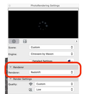

Jeff G
There was nothing special to download & install, except for the latest Archicad 25 update. Here's where I found it. I haven't had much of a chance to test it out yet.

DGSketcher
Legend
Open Photo Rendering Settings. Select Engine: Cineware by Maxon then a bit further down select Renderer: Redshift. I would imagine like many of us, unless you have a TOP specification graphics card then you will be politely told you can't run Redshift. I can't help thinking Redshift will be serving a very limited user group for some time. I have a two year old Mac with an 8Gb Radeon Pro 580X graphics card and it didn't make the benchmark.
