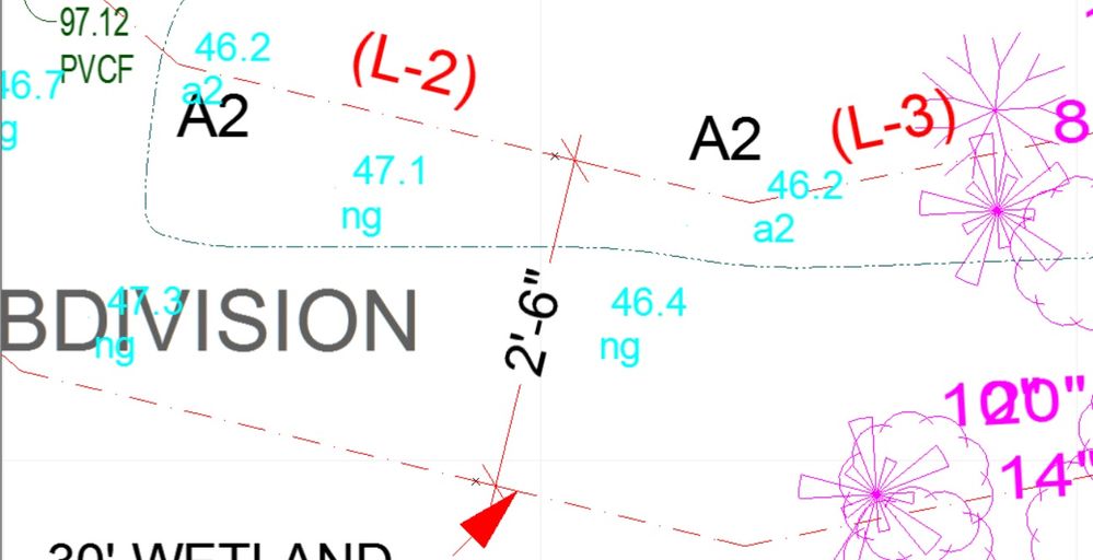

and what does AC measure on that particular dimension?

Cheikh:
When Merging, check the Translator in the Merge DXF-DWG Model Space dialog box. In the Translator, look at Drawing Unit, my guess it is set to 1 Inch rather than 1 Foot, since 2'-6" x 12 = 30'-0".
David
David

David,
Thanks so much. It worked.
Ilder,
AC was measuring 2'-6". Thanks.
Ilder,
