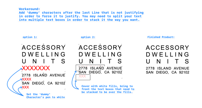

I've found a workaround.
Simply add a space, followed by 'dummy' characters until they reach the end of the text box. This will push the 'dummy' characters to the next line and justify the content on the previous line. Note that you may need to split your text into multiple text boxes in order to align it properly. Please refer to the attached screenshot and GIF for the results.

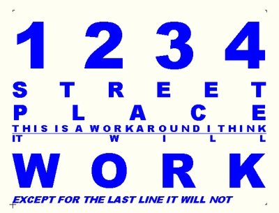

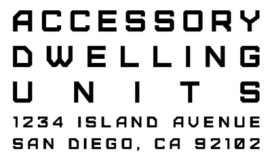

I believe I am using the wrong terminology to describe what I'm trying to do. Essentially I am converting all of my resources from Autocad to Archicad and my layouts use Distributed text that equally spaces all characters to the extents of the text box. I'm not sure if Microsoft Word has this feature, but I have used it in many graphics design programs previously.
I am actually able to somewhat emulate this in Archicad if I put a space in-between each letter of each word and double space each word, but it does not work on the last line.
Screenshot of the almost workaround in Archicad using Justified text:
Screenshot from Autocad that I'm trying to emulate using Distributed text:

Jeff-Taitano
Jan,
Thank you for this workaround! This should work until a Distributed text feature is implemented at some point.

Lingwisyer
Guru
More than just making the text white, you should probably also reduce it's size as it may show if you need to overlay anything or make use of the transparent background in some way.
