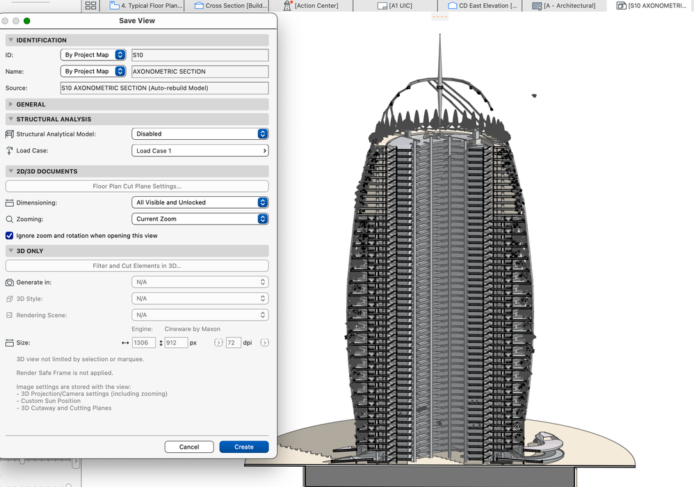

Unable to increase the resolution of a drawing.
On 3D Document, unable to increase the size of DPI other than 72. WHY?
Any comments?

For 3D views, the resolution is that of your 3D window. You can undock and set a custom resolution to achieve a higher quality image and there are other threads around here regarding that. The settings at the bottom of the dialogue shown are for render views only. Anyway, 3D documents are suppose to be vectorial are they not, so they should match what ever your printer / publisher resolution is set to.

"You can undock and set a custom resolution to achieve a higher quality image" Please explain. Once undocked the drawing, where can I change the resolution settings?
Thanks.
