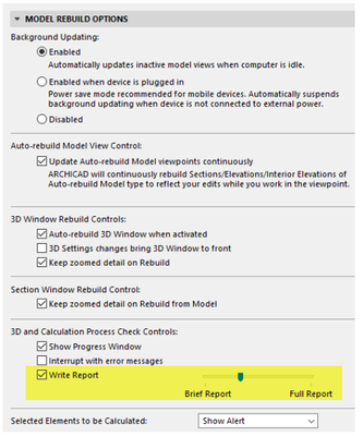

I've seen this complaint in the forums (fora?) going years back. When generating a 3D view, in a few projects I get an "Errors occurred during the last operation" (see attached screenshot). That's it. No context. Nothing in the session report. I have no idea if critical something is missing, if I've got bad GDL, missing texture.jpg, etc. Why is this so hard to fix? Periodically I try to weed through embedded libraries, etc. looking for potential performance bottlenecks. Seems quite like that the identified "error" could yield a performance problem, but no suggestion how to fix it!!!

In the Work Environment > User Preference Schemes > Model Rebuild Options.
To access the report use File menu > Info > Session Report.

I you set the reporting to maximum detail you will see the cause of the error - with specific ID of the offending element that you can then search for.
@JeffB Always learning in AC. How do you set the reporting to maximum detail?
Solution

Thanks a million for this tip. I fixed my problematic GDL code about 10 minutes after reading your comment above. The GDL code editor blessed the code, but would still cough up an error that showed up in Session Report once detail level was set to high.
