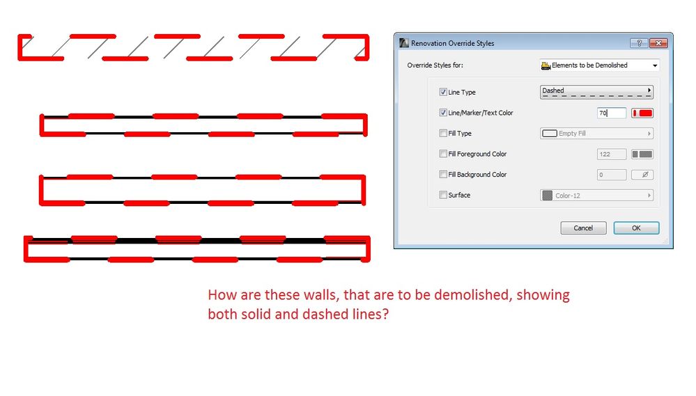

Running into an issue where demolition walls are showing the Renovation Filter option, but the result is having the correct dashed wall, but includes the solid line also. I only want the dashed to show.

Some times, renovation filters get mixed up (see image attached).
Make sure that "Existing Elements" and "New Elements" are set to "Show" and "Hide" respectively (for demolition filter).
If New Elements, for instance, are set to "show" or "override" they might show together with demolition ones causing your issue... same goes for the existing objects.
Thanks for the response:
The renovation filters weren't the issue. The issue came down to Renovation Override Styles. Some weird reason the wall composites fill were showing through, even though it was set to demolished. Changing the fill foreground to white overwrote the wall composites fill to show.
