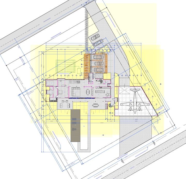

This morning I opened a file and it has a yellow water mark in every Section & Elevation mark.
I had to select all of them and "Send to Back" in order to be able to work in the file.
Thankfully it doesn't shows in the Layout Book but is very annoying to have them like this.
Any Idea what is the fix for this?
2 Replies 2
Eduardo Rolon
Under the View Menu go to
On-Screen View Options and uncheck
Highlight Source Markers
Eduardo Rolón AIA NCARB
AC29 US/INT -> AC08
Thank you Eduardo!!!
I have no idea when I did check that box but yep it was checked on.
Thank you so much.
