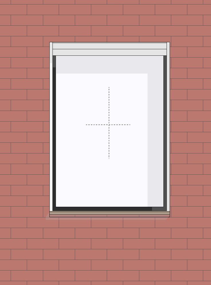

Hello everyone,
I would like to ask to the community, have anyone managed to fix this thing, so we need to present Fixed Glass with a cross on the middle, but there is no option of that sort, does anyone know how can I make a new option to show the cross whenever I put fixed glass?
*I am not much into GDL, but ready to go in if needed.
Thanks.

In my experience, fixed glazing does not show any symbol for the type of opening.
But I quite like the idea of a small '+' or 'x'.
If you are using the default windows from the Graphisoft library, you will have to put in a wish with your local support asking for this, as I don't believe it is an option with the standard windows - at least it does not seem to be with the windows in the AUS library.
If you are using other 3rd party windows, you will have to ask them.
Otherwise it would be a matter of drawing this on yourself.
Either manually with lines, or create your own object that you can place.
Or maybe save the lines as a label so you can place without the leader line.
This way it will be associated with the window and if you move/delete the window the label will move/delete as well.
JeffH
You could create a new Symbol fill with the desired look, and create a "Fixed Glass" surface that has the newly created fill set as it's cover fill.
Then simply use that glass for the instances where it is a fixed window.
I don't know if or how you would be able to get it to center in each window though

Hi Jeffh, did try it, but it's a bit complicated working with hatches.
Thanks for the Idea, didn't came up to my mind.
