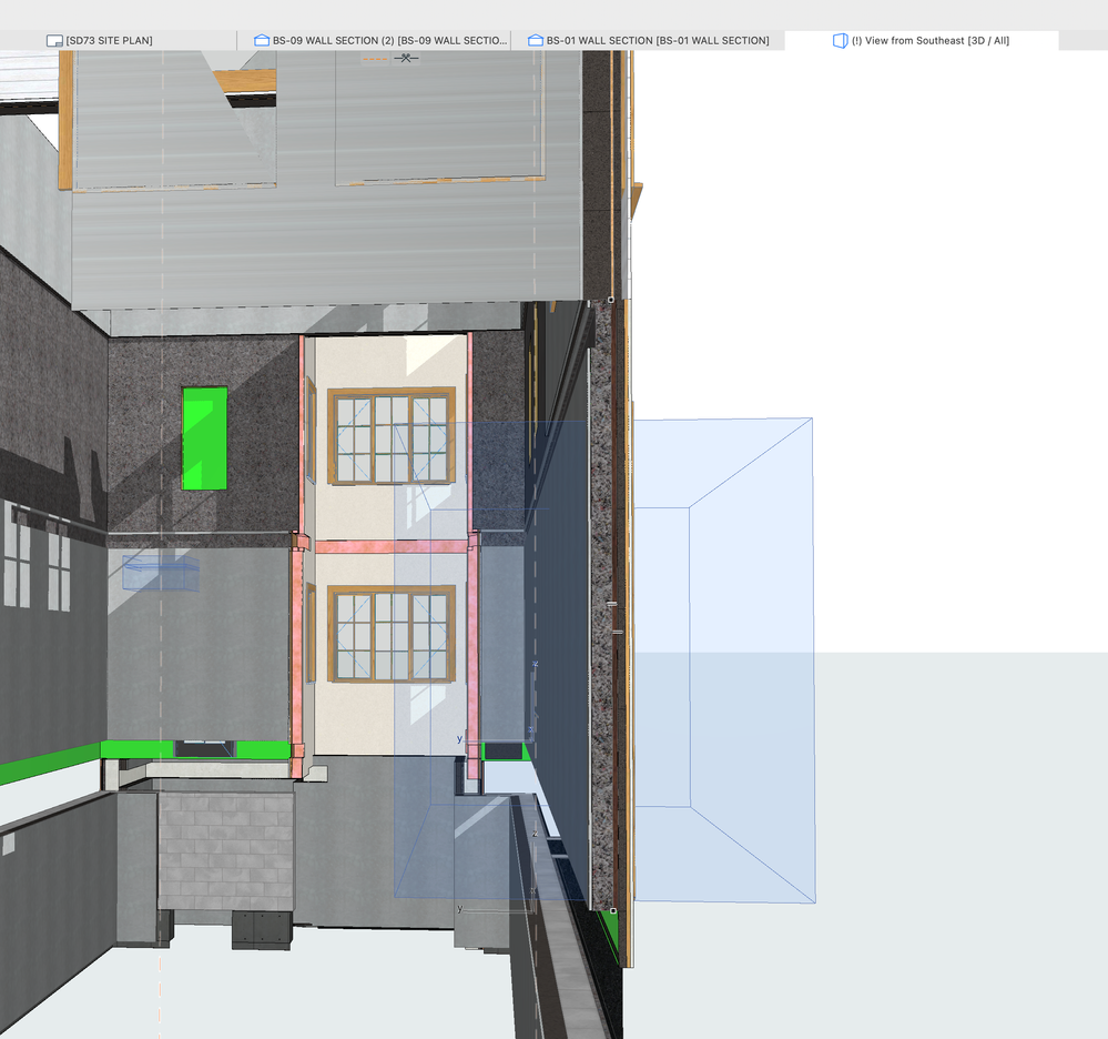

Further to above, when I turn on View / Opening Cutting Bodies to see if it is working the Cutting Bodies are shown. See attached. The cutting body does not "cut through" the other parallel wall composites. (I'm assuming it can cut through multiple composites).
The three composites were on different renovation filters. I changed them all to the same and it still does not work.
What am I missing?

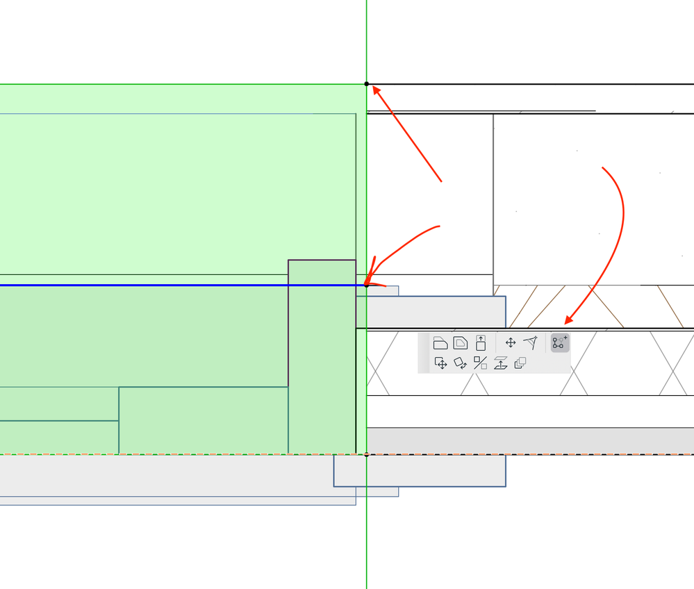

With the Cutting Bodies viewable on the floor plan you can expand the cutting body nodes to cut through other elements. This looks like a manual process but it works. From pet palette select the tool button shown in the image attached below. Then adjust the nodes on plan.

g r a n t
WELL.....looks like it works for doors but not windows???
AC26
USA library.....
G
