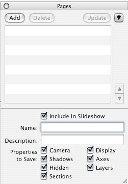

am i missing something obvious?You must be, because it's never been better or easier (once you grasp it) IMHO.

People were divided about this earlierThey were?
Pen Sets should be applied and remembered with each View just as with all other settings which affect output.That would assume views are only used for output.
I know there are others with a different view on this though
2006-07-13 08:57 AM
Link wrote:I obviously cant post the thread here but thats my recollection anyway, and im sticking to itPeople were divided about this earlierThey were?
Link wrote:Not making any assumptions about what people use views for. I know some will be using Pen Sets to have Drafting and Output pen colours. I've got a similar setup with Drafting and Output viewsets (markups, setup lines, notes etc). But GS had said generally they thought that Views should be where you defined a drawings appearance, not on the Layout. We didn't always have Scale override under Drawing Settings AFAIR ..Pen Sets should be applied and remembered with each View just as with all other settings which affect output.That would assume views are only used for output.
Link wrote:I think we agree for the most part - i just think you should be able to save Pen Sets with Views in the modelling environmentI know there are others with a different view on this though
I guess I'm one of those mate (with all due respect). For the point of conversation, I believe that the current method of having working pens and mapping them to drawings for output at the publishing stage is the correct logic. We can have different pensets in the modeling environment vs. the layouting environment.
I'd be keen to hear why it's not floating your boat...
