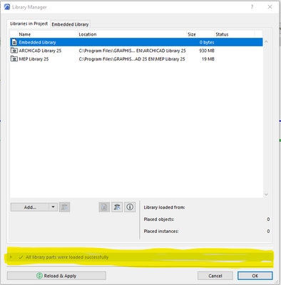

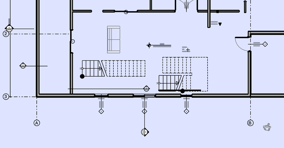

why do my stairs have black dots (like missing library parts) on the stair baselines?

I would say it is a missing library part.
It could be the stair numbering, or the description.
Check through all of the parts of the stair in the settings.
Maybe it is something to do with the railing.
Is there anything missing in your library manager report?
Can you select it to see what it is (may have to go into 'Edit' mode for the stair.

Lukas Zeleny
check Library part manager if there are any missing elements, it can give you hint whats wrong with the stairs.
