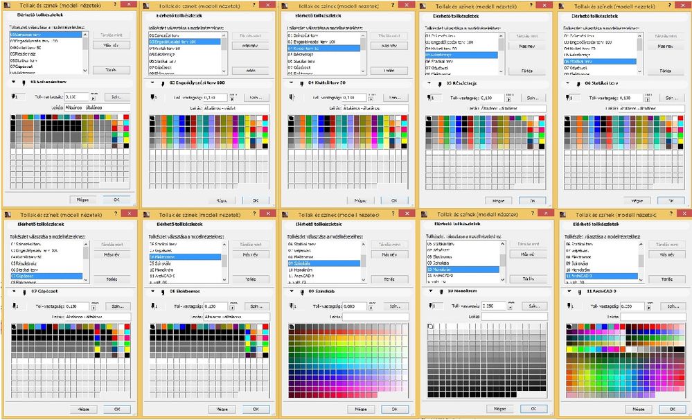

These are my pensets.
It is a lot of work to go through each object that I've placed and change its colour. There must be an easier way.
