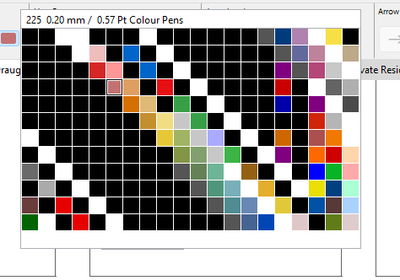

Good day Everyone
How do i resolve this, my pen sets in archicad keep on displaying like this even if i arrange them correctly in the pens & colours tool.
Please assist
1 Reply 1
Your operating system (I am assuming Windows) display scaling is not set to 100%.
Archicad does not like it if it is not 100%.
It is better to use 100% scaling and adjust your screen resolution to something smaller to make what is on your screen appear larger.
