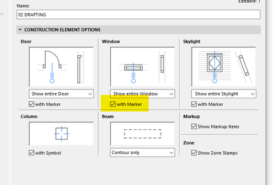

Window marker settings?
MVO => [Relevant Combination] => Construction Element Options => Window => with Marker?

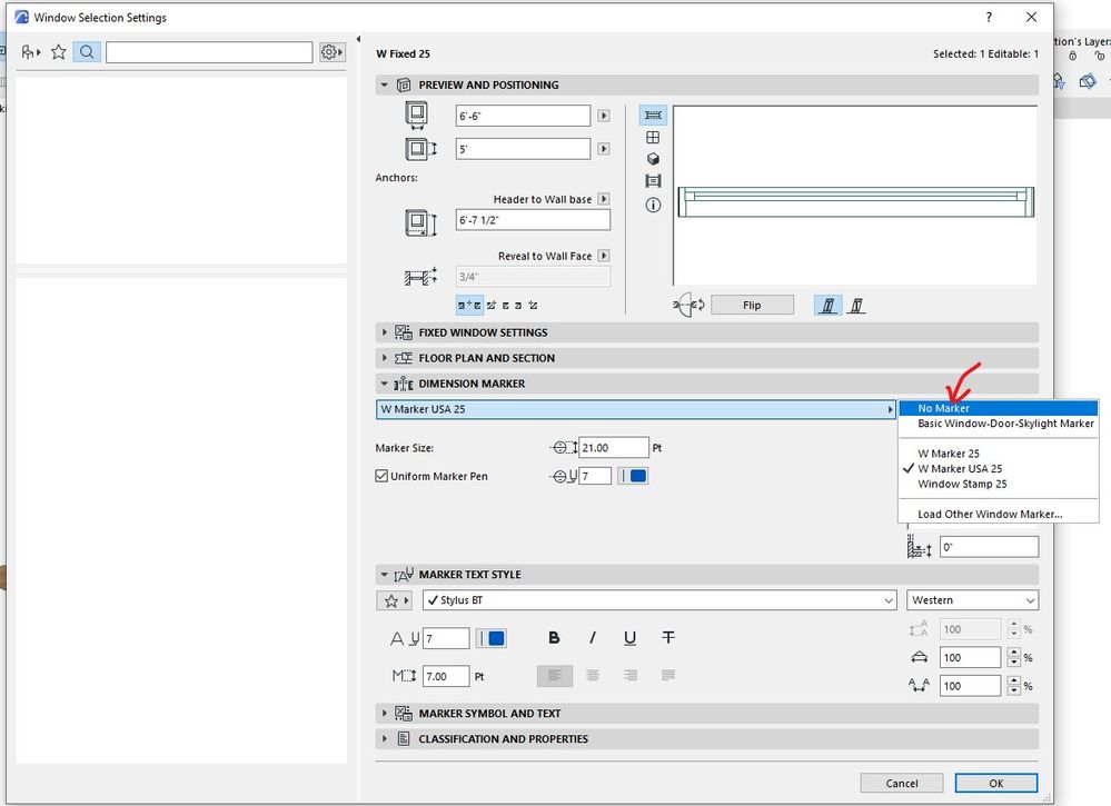

sknsnw9
Here's the screen shot to find the setting:
