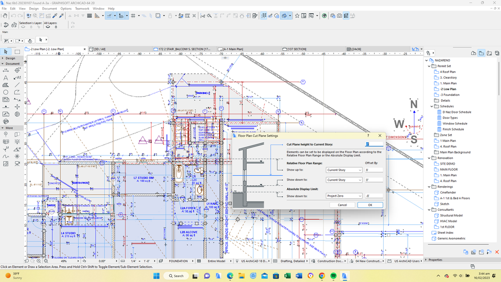

This Floor Plan Cut Plane has to be reset every time I open my Lower floor plan. This command works fine for the Main floor plan.  What am I doing wrong?

Select the view you are opening from the Navigator then click settings and select the Floor Plan Cut Plan button. You can set the Floor Plan Cut Plane relative to each view so it is remembered. If you set it from the main menu once the view is open it won’t be remembered and will be reset when you open an alternative floor plan view.

The FPCP is saved with each View.  Ideally, you should be navigating Views as you work on your project, once everything has been set up.
