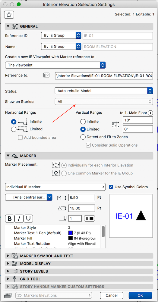

my interior elevation markers are showing on all stories, and i know i should be able to select which stories, but in this case that option is greyed out.

You need to select the entire interior elevation group rather than a single elevation.
There have been many post about this selecting before - here are some.
http://archicad-talk.graphisoft.com/viewtopic.php?t=50027
http://archicad-talk.graphisoft.com/viewtopic.php?p=245542
http://archicad-talk.graphisoft.com/viewtopic.php?p=245540
Some of these may be a little old and I am not sure if it might be slightly different in later version, but it should put you on the right track.
I don't use interior elevations so I would have to experiment if you are still having trouble.
