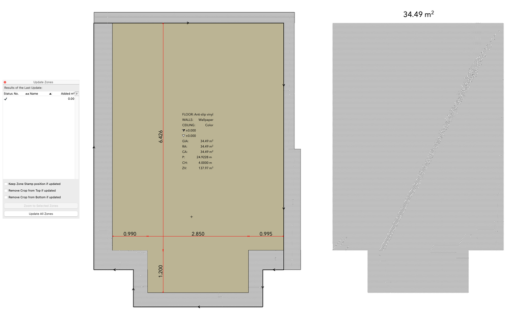

I have an automatically generated Zone (used Inner Edge) surrounded by simple walls. Floor to floor height is 4m. No doors on any wall.
Why is it calculating the correct zone area, correct wall perimeter, but incorrect wall surface?
I have confirmed that all four walls are part of the zone - look at wall parts in the right-most column.
As per the dimensions in plan view, area is correct at 34.49², also confirmed by the fill at right.
Perimeter P is also correct, 24.9228m
Ceiling Height CH is correct, 4m
Zone Volume ZV is correct, 34.49 x 4.00 = 137.97m³
Why is Walls Surface Area in column 4 wrong? It shows 95.29, it should be 99.6912, i.e. 4.40m² more than showing. It's like it's ignoring 1.10m of wall length.
The zone heights are correct, both floor and ceiling linked to the stories elevations.
This is happening with a few although not all of my project's zones. What am I missing, guys?
Archicad 29.0.2 (3200) INT; macOS Sonoma

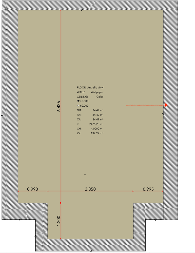

If you change the thickness of walls, is the result the same?

Do the bottoms of the walls line up with the bottom of the zone and the tops of the wall line up with the top of the zone?

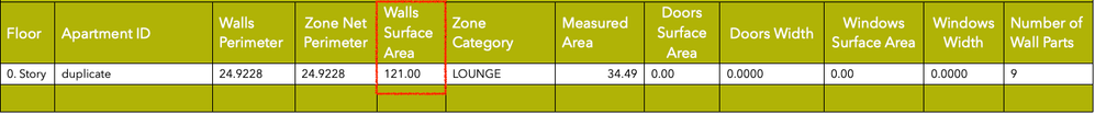

Thanks Mathias, interesting. I changed the two different-thickness walls at right, to make them a single wall of the larger of the two thicknesses, like this:
Without updating the Zone, I simply selected it and right-clicked on the schedule, to view only that one. This resulted in Walls Surface Area now had jumped to 121.00 (from the original 95.29).
I updated the Zone in plan view, and the 121 dropped back down to the previous 95.29.
I played around with various walls and their thicknesses and reference line direction, it stayed at 95.29. If I broke a wall in two parts of different thickness (while maintaining the floor area the same), then it may spike to 121m² but then, after updating the Zone, it always drops back down to the 95.29.
As a reminder, all walls and the zone itself are set at 4m height. No reductions enabled (due to roof/door/window/wall/column/fill etc). Since the perimeter is (correctly showing in the schedule) 24.92m, I would expect the walls surface area to be 24.92 x 4 = 99.69, not 95.29. It seems that it's always 'missing' 4.40m² (or 1.1m of the 4m-high wall).

Yes, they do. All walls and the zone itself are set at 0.0000 bottom, with a 4.000m height. There are no slabs, no roofs, no beams, no columns, no doors, no windows, no openings to interfere with. Just a room made of 9 walls and a zone inside.
FWIW I have also deleted all 'ignore element holes if' and all 'ignore component holes if' rules in Project Preferences > Calculation Rules.

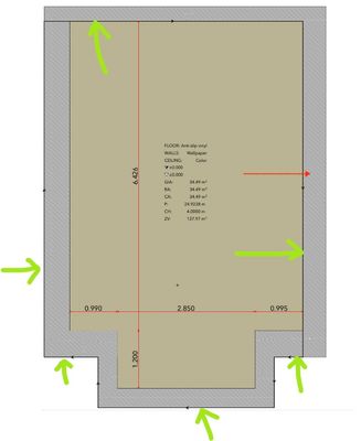

Did you check whether the issue comes from the wall’s reference line?
Try setting the wall’s reference line to the interior side only and see if that fixes it

Hi @CIA20 , thanks. No, reference line isn't fixing it. Plus, it'd be impossible to do that - if it was the case and it did fix it on one side, you'd have the issue with the zone on the other side of the wall.
But no, it isn't the issue.
