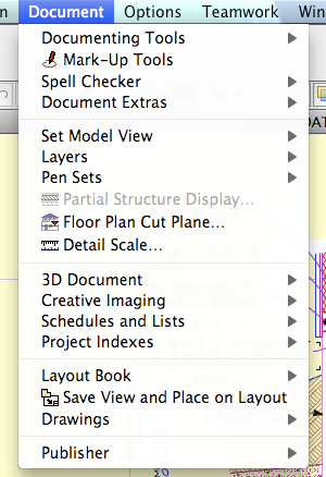

Why would the Partial Structure Display be gray (unavailable) in the menu? I am working on a detail drawing and am having difficulty with dimensions displaying, which I believe is also making havoc with my creation of PDFs from layouts. I would like to delete dimensions that are not on proper structure display mode and then redo them on my desired Partial Structure Display mode, but I don't know how to control this mode in detail views. AC14.
Your detail is apparently an "independent" (unlinked) detail - no connection to the model at all. That's the only time I can reproduce the behavior you see. Normally, details are linked to a source view - and whatever PSD setting is used by the source view is used by the detail (and can NOT be changed - you must capture a different source view if you want a different PSD, or be willing to change the source view).
A detail drawing that was once linked can become independent if you delete the detail callout marker from the source view - you'll be asked if you want to keep the detail as an independent detail. At that point, it is just a capture of linework and fills. A bit risky for things like wall sections if the model changes, as the detail will not reflect the changed model. Not a big detail for 'typical' details that are just 2D drafting anyway.
To get a linked detail again, you'll have to place a fresh source marker in a proper source view.

Karl - Thanks for your suggestions. That helps greatly with my understanding. Perhaps the PSD is not actually the root of my current problem, which is of having my PDFs not open or print correctly. PDFs are what I send to my print service. I am attaching files of what my PDF looks like and the error message I get when I open the PDF. Not all my detail files are causing problems and I was only suspecting it to be a PSD problem. I've been doing details the same way for a while and have never encountered this before. I just did a hotfix update, hoping to correct, but no improvement. The problem presents itself as a text-missing problem, but my printer service tells me the page won't print at all. It prints as viewed on screen (missing text) on my office printer.

Well, I rebuilt the offending details and got my layout to make a clean PDF. In the process I sharpened my suspicion that it had something to do with dimensioning, which I still don't clearly understand. I could not find a control for this in dimension settings, but when I option-clicked on dimensions that behaved properly in another detail, I was able to successfully use those settings in my reconstructed details.

cremsberg
I used the same font that works successfully elsewhere. See earlier post above, Picture 7 - PDF, which shows snapshot of my PDF and the detail where the text is missing, even though I think it was the dimensioning which was screwing up the works. I was using Publisher to create the PDF of my layout page. Final word - my problem for the day has been solved, but I wish I understood the underlying issue better. I strongly believe it is an AC14 and later issue.
