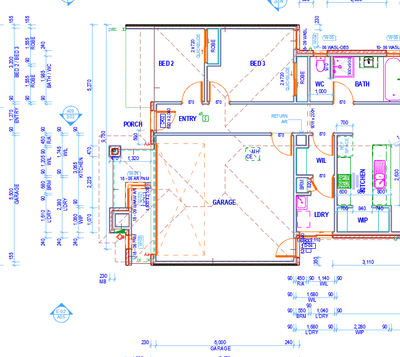

hey all,
is there a way to show ALL renovation options in one reno filter ?
i work on files that have different "design options" using renovation filters. when it comes to mirroring, the only activated filter is being mirrored, im tryng to find a way to mirror the whole project including all renovation options and layers.
please find snippet for example
mirrored file with selected renovation option.
mirror file with different reno option.
Solved! Go to Solution.

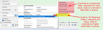

So with renovation filters, you can set the 'renovation status' of an element as new, existing or to be demolished.
You can then set 'Filter Settings' to show, hide or override each renovation status in each of the renovation filters.
This i am sure you know.
As you change the renovation filters used, your elements will show, hide or override as you have set them up.
Unless you 'pin' them to show only with a particular filter.
Then they will only show, hide or override when that particular filter is used - which is what you seem to have done with your Facade 1, Facade 2, Facade 3 filters.
So to see all of your elements at the same time, you will need to set them to show on all relevant filters.
But of course this will then mess up the ability to show only one facade at a time.
There is no other way to show all of your facade options at the same time.
So it is possible to use renovation filters for design alternatives as you have done, but this is one of the downsides.
And that is why we now have Design Options in 27, so we can have alternative options and the ability to show just the one option at a time or all at the same time (which is messy but important when mirroring a plan as you are doing).

‎2023-10-16 07:26 AM
apologies.
yes im talking about renovations filters.
all filters are on one renovation status (new).
the main question is as follow :(is there a way to show all renovation filter items even if they are allocated to a different renovation filter?)
eg. please see snippet below:
if there is a wall associated with "facade 1" and other wall is associated with "facade 2", is there a way to show them both in one view? the reason for this just purely for mirroring project.

‎2023-10-16 07:59 AM
In fact you could even set up a mirrored plan as a design option if you want to and not have to physically mirror the plan yourself (except when you first set it up).

‎2025-01-07 05:53 AM
You can't show just those elements in a particular renovation filter as visibility is controlled by the status - existing new and demolished, as well as the fact that is is set to show only when in a particular filter.
But you can use Find & Select to select those element in a particular filter.
