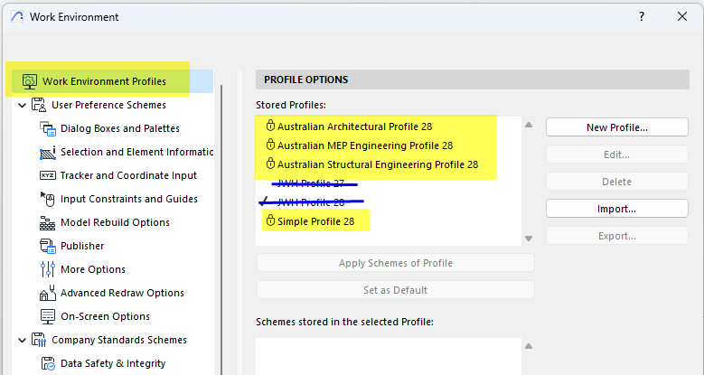

It looks like you might have a custom Work Environment applied, I don't see any default menus like that.
The WE will affect what you see in the menus and the keyboard shortcuts.
But I always thought the Explorer shortcuts were hard coded and couldn't be changed - at least I see no way of changing them.
Maybe open your Work Environment palette and apply a default WE.
If you are using custom settings, make sure those profiles have been saved so you can switch back if you need to.
These are the standard WE profiles I have, but I have the AUS template.
You should have similar options for a standard Architectural profile.
