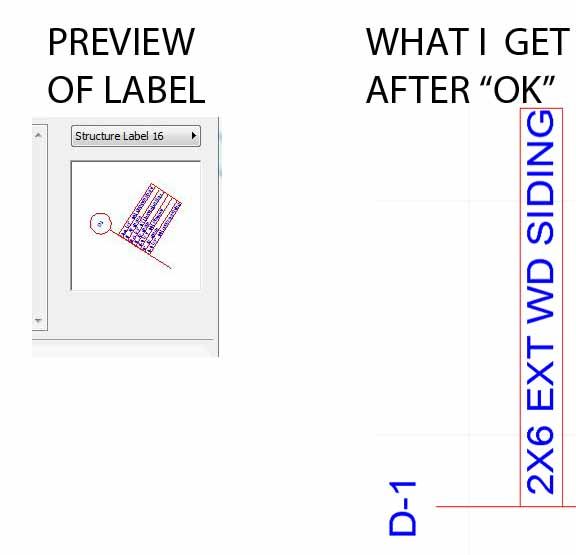

does the structural label tool not work with walls created in profile manager?
I can make it show in the preview window when i select structure label but as soon a i hit the ok button it changes to a one line wall tag.

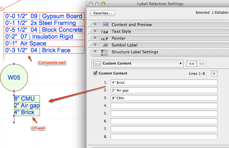

Maybe a picture will help!
Erika Epstein
Correct, as a CP wall can have elements that aren't like a composite.
Instead you need to use the CUSTOM CONTENT on the Structure Label Settings Tab.

Custom profiles help so much in eliminating drafting in sections so it is a advantage to use them. It is amazing to me that when you select the structural label it shows all the contents of the wall in the preview window, so it really looks like a small bit of code was omitted, however cadimage coverings is the same way- it works with composite walls but not with profiles.
INTERESTING! have 15 migration lib loaded select 15 wall label on custom wall profile and it will list all elements!
