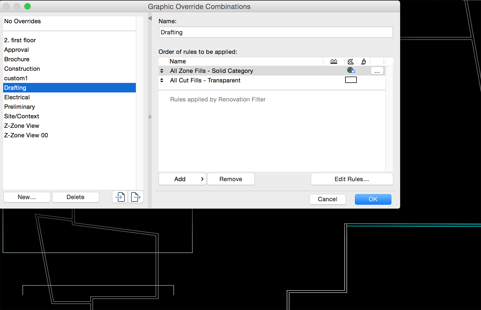

- walls on correct layer
- cyan is selected as the line color
- cut plane set to 3'-6"
the only way to make the walls show up cyan is to make the wall start 3'-1" below the floor level.

nancylee wrote:Did you check Floor Plan Display Options ?
drawing up a new plan in Archicad 20, which I'm still learning, and the walls are drafting in as gray and not cyan.

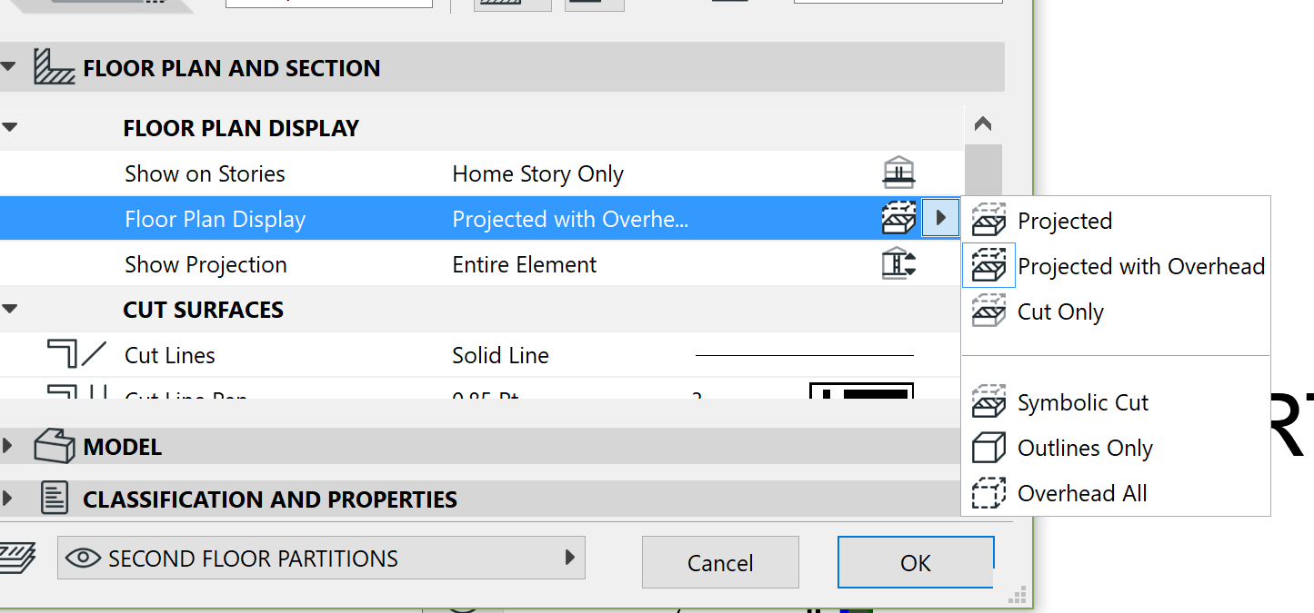

2017-11-09 05:29 PM
The wall setting is set for cut and overhead projection. When I change it to other things the color stays the same.
In the screen shot you can see one wall that's cyan (it starts 3'-6" below the floorline) the rest start at the floor line and show up gray.
