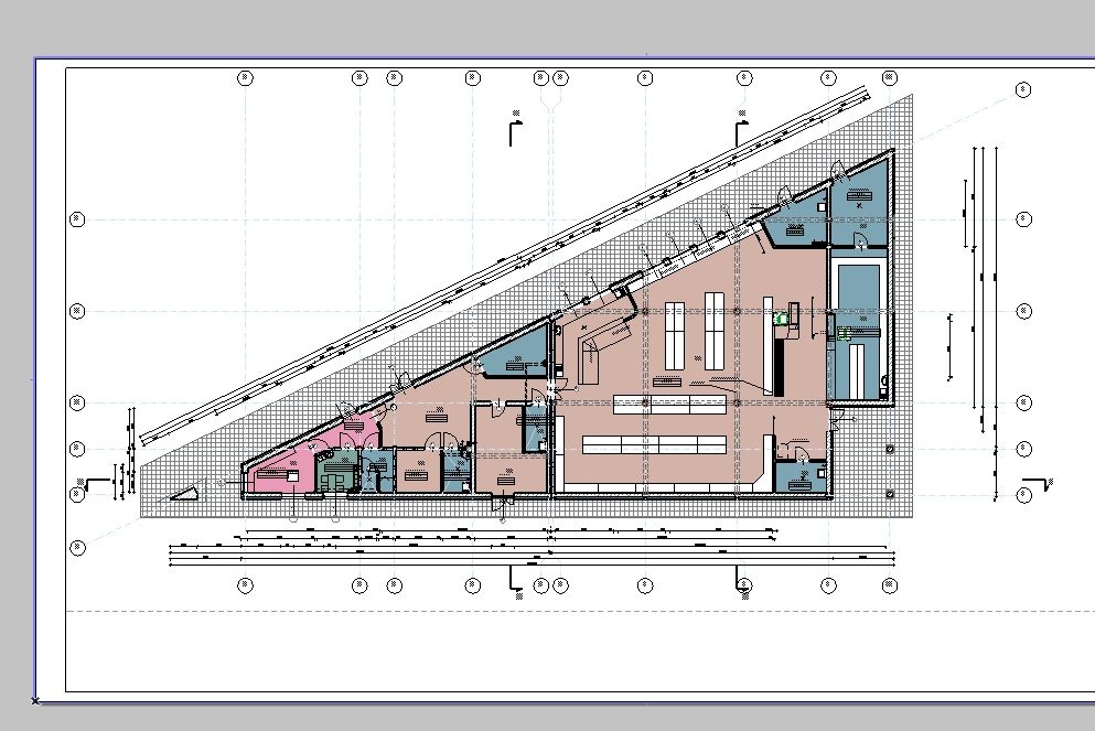

sorry if this topic was mentioned before, but i wasn't able to find the solution on my own (even google didn't help at all)
Is it possible to turn off zone fills in prepared for print sheet? As suggested somewhere, i have turned off display of zone's background in model view options (Alt+Shift+2) but it is not affecting final plot.

The solution is in the Model View Options as you tried, but every view has its own MVO setting.
So you should:
1. Go to Document/Set Model View/Model View Options: set a custom fill display and store the desired settings as a new MVO combination
2. Go to the Layout
3. Select the drawing and right click on it -» Open Source View
4. Switch to the View Map in Navigator and open the selected view's settings dialog
5. In the View Settings/ General tab now you can select your custom MVO
The layout drawing needs to be refreshed.

Thank you for the tip.
Yes, it worked out very well
