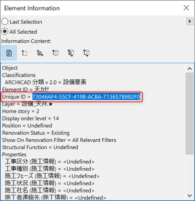

Retrieve the unique ID of the element from Archicad and convert it to a QR code.

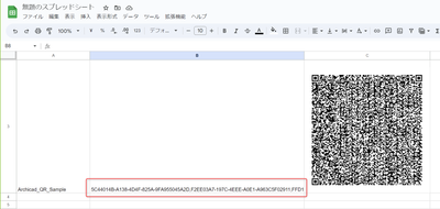

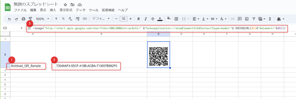

Links can be generated to Archicad members using custom URL schema.
In this case, the QR code was generated from a URL using Google Spreadsheet, but it can also be generated using Python or other tools.
=image("http://chart.apis.google.com/chart?chs=200x200&cht=qr&chl=" &"bimxapplication://showElementIn3dContext?hypermodel="& ENCODEURL($A2&"&element="&$B2))

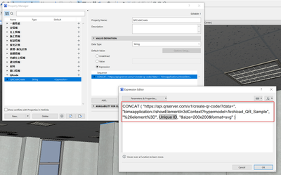

[Appendix1 : Show QRCode in BIMx]
The QR code API can be used to display QR codes on BIMx from all elements.
This allows people who cannot use Archicad to generate and pass QR codes (either in person or via email, etc.).
[Appendix2 : Multiple Elements]
Multiple elements can also be highlighted in a single QR code.
Simply connect the unique IDs with commas.
Note, however, that there is a limit to the length of character string that can be represented by a QR Code.
