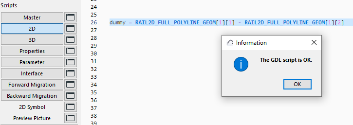

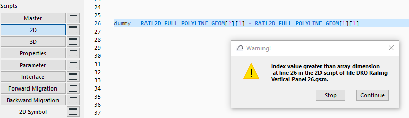

But I can't seem to use RAIL2D_FULL_POLYGON_GEOM to get the coordinates of the 2 points:
- If I use RAIL2D_FULL_POLYGON_GEOM[2][1] - RAIL2D_FULL_POLYGON_GEOM[1][1], I have the following error
- With RAIL2D_FULL_POLYGON_GEOM[1][1] - RAIL2D_FULL_POLYGON_GEOM[1][2], the script is ok, but this is not the value we look for (which should be x2-x1)? And the result is 0.0000 anyway
- Last attempt: if I would consider the first point to be 0,0, and the second point is actually what can be pulled from RAIL2D_FULL_POLYGON_GEOM, then the result of this command
dummy = sqr(RAIL2D_FULL_POLYLINE_GEOM[1][1]^2 + RAIL2D_FULL_POLYLINE_GEOM[1][2]^2)
print dummy
is 0.0000 in Report dialog

Peter Baksa
Oh I see. During check script global variables might not be filled with sensible geometric data like they would when the object is placed in the plan.
Check with vardim1 whether the array size is good for your calculations.
