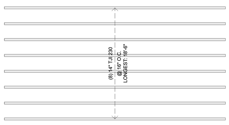

  4. Smart floor plan labels. Flexible text for member mark, quantity, size, spacing, pitch and length, with a span arrow across repeating members; any of which can be toggled on/off (useful when reviewing supplier layouts).

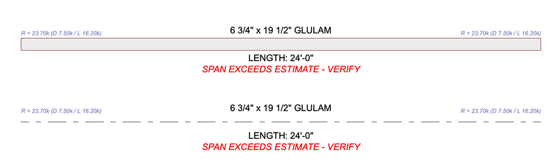

  5. Span checker. Estimates the allowable span for joists, rafters, beams and headers, and the capacity of single posts, with tributary widths, point loads and an overhang. It prints a warning beside any member that's over, and reports end reactions in kips and a minimum bearing length.

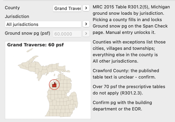

  6. Code cross-check and Michigan snow loads. Compares each member against the prescriptive span tables in the Michigan Residential Code 2015 or IRC 2015 to 2024, and fills in the ground snow load from a 83 county and jurisdiction picker. The object can even suggest the county from the Project Location coordinates, and highlights the selected county on the map in the dialog.

Smart Integrated Floor Plan Data
Michigan Snow Load Selector
Span Checker
