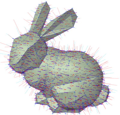

Full res bunny example:
69664 Faces, 34834 Points
Screenshot 2025-10-25 232153.pngScreenshot 2025-10-25 234639.pngScreenshot 2025-10-25 234900.png
rudl
"Hair"
Face - Normals added

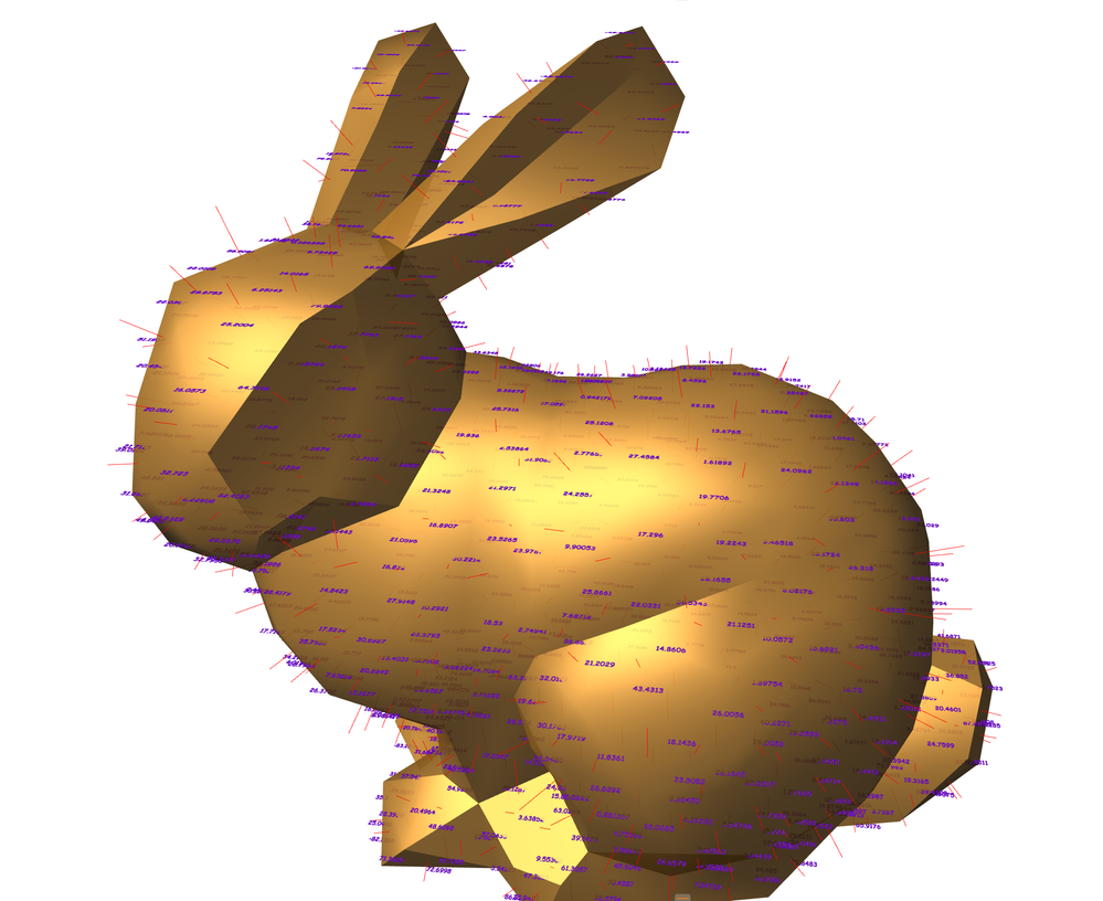

rudl
*) Edge Angles
*) Edge Visibility/sharp edges based on edge angle.
rudl
Face and Vertex numbering, Point normals etc
