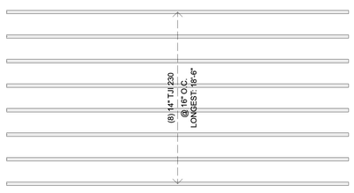

It has parameters to show the member type, size, quantity, on center spacing, length, pitch, etc. right on the plan.  The text can either be aligned with the object, or if multiple elements are shown, such as a repeating I-joist floor system as shown below, the text can run perpendicular to the framing, with an arrow. This arrow, framing type, quantity, on center spacing, length, slope can be individually turned on or off. This will make it easy for me to toggle this information on/off when reviewing layouts from lumber suppliers.  See below, showing a single placed object showing multiple framing elements and the optional (automatically generated) data describing the framing.

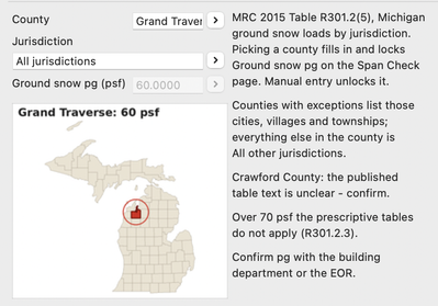

Taking it a step further, an optional built-in span checker was also incorporated. Since a majority of my work is in Michigan, I had Claude add a dropdown that allows me to choose which county the building site is located in so that it's able to use the exact snow load design values for that region, without requiring me to look at a snow load map. The interface also highlights the selected county on the map of my state.

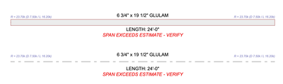

If I model a beam, rafter or joist system longer than what the span charts allow based upon the span, tributary width, dead load, live load & engineering properties of the member, the object displays a warning in red text indicating this. I'm able to have the object show the weight at each end, measured in kips.  Below, I've shown two beams (objects), one with centerline only and the other showing the entire beam, both with the weight at each end (total reaction, dead load and live load). Both beams were longer than the engineering properties allowed, so they show the warning in red text.
