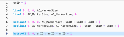

Perhaps try adding a unID

vlahtinen
Unfortunately this didn't fix it. Good thinking though, thanks for the suggestion!
