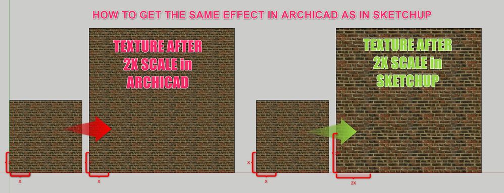

Hi, guys. Could you please help me achieve the same scale effect as in SketchUp? The Unproportional Scale is also what I need. Thank you.

COOR{3} can determine the origin of the surface, it direction and the method it is wrapped, but I am not 100% sure if it can stretch the surface.
Does it need to be done in GDL or can you just create a duplicate surface and increase the size of the texture?

it should be a GDL, I need it for the multiple-use case.
2023-03-13 05:17 PM - edited 2023-03-13 05:19 PM
It's possible to scale a texture dynamically by having a DEFINE TEXTURE with scaling variables (and then doing a DEFINE MATERIAL with said texture) but I don't know if it's possible to extract the texture name from a REQUESTed material.
If you already know which texture you want, you could hardcode it directly maybe.

It's possible, even tho you must need to do some contortions.
file_name = ""
rrr = request{2}("Material_info", old, "gs_mat_texture", file_name, w, h, mask, alpha)
define texture "new" file_name, w*2, h*2, mask, alpha
tex_id = ind(TEXTURE, "new")
str_name_of_mat = ""
rrr = request("Name_of_Material", old, str_name_of_mat)
define material "new_mat" based_on str_name_of_mat,
parameters gs_mat_texture_ind = tex_id
mat_id = ind(MATERIAL, "new_mat")
material old
brick 1,1,0.1
addx 1.3
material mat_id
brick 1,1,0.1
