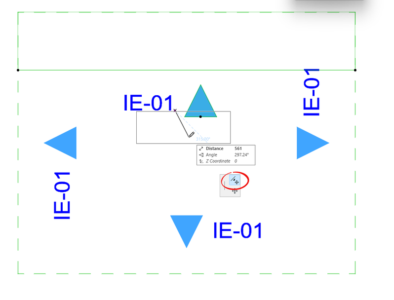

I am working on a Common IE Marker subtype and I can't seems to make editable hotspot to work, unlike Section/Elevation and Individual IE Marker. I also notice that a hotspot on "Common IE Marker 2" doesn't work, at least for me. There's no "Move Node" available on the pet palette.
Does anyone has the same issue?

I can confirm that hotspots are not editable in markers of the Common IE Marker subtype. The only available option in the pet palette is to move the entire marker. If the same code is used in a regular object, the hotspot behaves normally.
I tested this in Archicad 29 (build 3200), both FIN localization and INT version, on macOS Sequoia, and the behavior is the same in both.
I’ve attached a simple test marker object for reference.
There are no editable (pink diamond) hotspots.
But you should be able to move and rotate the marker.

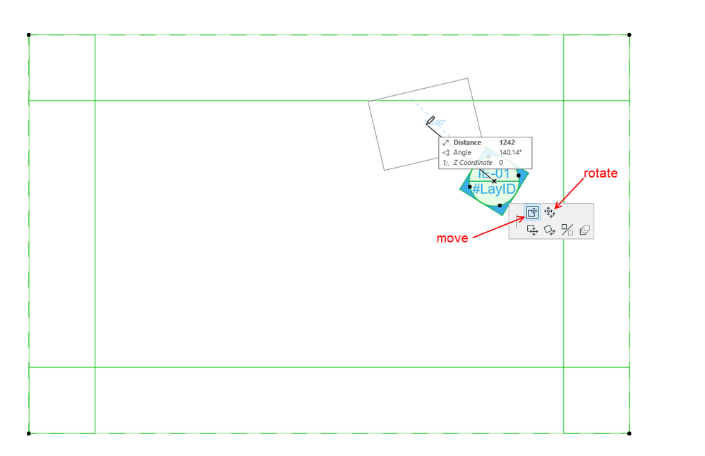

This is what I see in 29.

And thank you, @Barry Kelly . My goal here is to create Editable Hotspots to change some parameters, apart from location and rotation angle.
It's kinda weird though. You can script the Editable Hotspots and the hotspots are even show up correctly. The only missing part is the "Move Node" option on the pet palette.

Maybe the pet palette is hard coded to show only those options when the interior elevation marker is selected.
Like it will show slab edge options only when a slab is selected.
As it is coded in the program, I am not sure there is anything you can do about it in GDL.
So yes, you can script the hotspot, but can't control the pet palette.
vlahtinen
You’re right — GDL cannot directly control the pet palette.
However, the pet palette should still react to an editable hotspot. In this case, I think the behavior should be considered a bug.
Even the default Common IE Marker 2 that ships with Archicad 29 includes a movable hotspot.
Since this affects the out-of-the-box library part as well, it seems more like an inconsistency in how editable hotspots are handled in IE markers. At the very least, this limitation should be clearly documented.

The individual marker has a pet palette option to move a hotspot.
