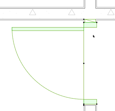

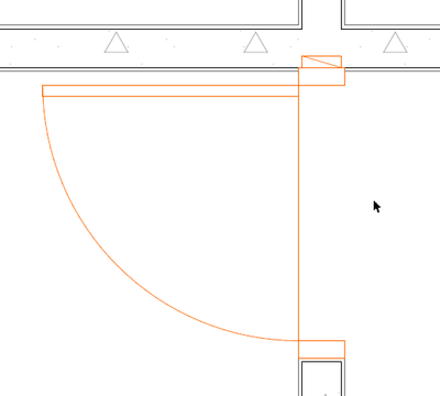

I want to install it including the value of oversize, but it goes like this.
1. I want to code a door like this.
2. I want to turn off hotspot2 of ac_unit_width in floor plan
Only ac_wallhole_width is used, but it is difficult to select.
