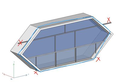

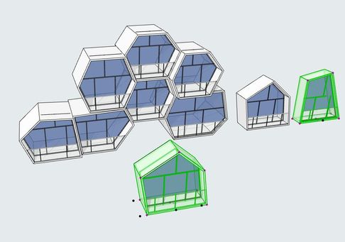

yongler
The GDL component has been made using CUTPLANE. This allows you to freely drag and drop hotspots, freely design various shapes of exterior windows, and have a choice of 4-6 edges.
yongler
I have found a better way to use CUTFORM.
The status code of CUTFORM allows for the selection of whether cutting is done externally or internally.
Thank you all. 😊
