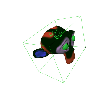

rudl
*) Monkey read from text-file
*) Arbitary rotation around an axis rodriques transformation
*) Display Helper Axes

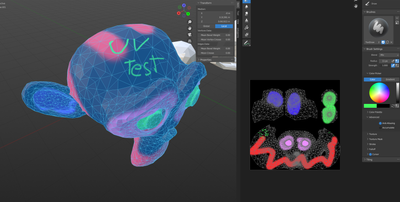

rudl
UVs
