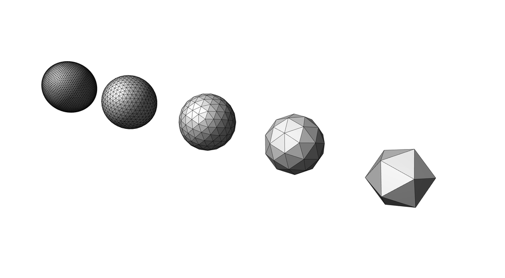

2026-05-29 12:17 AM
UVs
9 hours ago
Subdivided Icosahedron / Geodesic
needs some polishing but works
FOR i = 1 to nFaces
IF f_pi[i][1] < f_pi[i][2] THEN
edge_temp[1][1] = f_pi[i][1] : edge_temp[1][2] = f_pi[i][2]
ELSE
edge_temp[1][1] = f_pi[i][2] : edge_temp[1][2] = f_pi[i][1]
ENDIF
IF f_pi[i][2] < f_pi[i][3] THEN
edge_temp[2][1] = f_pi[i][2] : edge_temp[2][2] = f_pi[i][3]
ELSE
edge_temp[2][1] = f_pi[i][3] : edge_temp[2][2] = f_pi[i][2]
ENDIF
IF f_pi[i][1] < f_pi[i][3] THEN
edge_temp[3][1] = f_pi[i][1] : edge_temp[3][2] = f_pi[i][3]
ELSE
edge_temp[3][1] = f_pi[i][3] : edge_temp[3][2] = f_pi[i][1]
ENDIF
mid_indices = mid_indices_clear
FOR j = 1 TO 3
p = 0
IF edge_key[edge_temp[j][1]] [1] # 0 AND edge_key[edge_temp[j][2]] [1] #0 THEN
FOR l = 1 TO edge_key[edge_temp[j][1]] [1]
FOR m = 1 TO edge_key[edge_temp[j][2]] [1]
IF edge_key[edge_temp[j][1]][l+1] = edge_key[edge_temp[j][2]][m+1] THEN
mid_indices[j] = edge_key[edge_temp[j][2]][m+1]
p = 1
ENDIF
NEXT m
NEXT l
ENDIF
IF p = 1 THEN
ELSE
nPoints = nPoints + 1
FOR k = 1 TO 3
po_s[nPoints][1] = (po_s[edge_temp[j][1]][1]+po_s[edge_temp[j][2]][1])/2
po_s[nPoints][2] = (po_s[edge_temp[j][1]][2]+po_s[edge_temp[j][2]][2])/2
po_s[nPoints][3] = (po_s[edge_temp[j][1]][3]+po_s[edge_temp[j][2]][3])/2
NEXT k
countm = edge_key[edge_temp[j][1]] [1]
countm = countm +1
edge_key[edge_temp[j][1]] [1] = countm
edge_key[edge_temp[j][1]] [countm +1] = nPoints
countm = edge_key[edge_temp[j][2]] [1]
countm = countm +1
edge_key[edge_temp[j][2]] [1] = countm
edge_key[edge_temp[j][2]] [countm +1] = nPoints
mid_indices[j] = nPoints
ENDIF
NEXT j
f_pi_temp[(i-1)*4+1][1] = f_pi[i][1]
f_pi_temp[(i-1)*4+1][2] = mid_indices[1]
f_pi_temp[(i-1)*4+1][3] = mid_indices[3]
f_pi_temp[(i-1)*4+2][1] = f_pi[i][2]
f_pi_temp[(i-1)*4+2][2] = mid_indices[2]
f_pi_temp[(i-1)*4+2][3] = mid_indices[1]
f_pi_temp[(i-1)*4+3][1] = f_pi[i][3]
f_pi_temp[(i-1)*4+3][2] = mid_indices[3]
f_pi_temp[(i-1)*4+3][3] = mid_indices[2]
f_pi_temp[(i-1)*4+4][1] = mid_indices[1]
f_pi_temp[(i-1)*4+4][2] = mid_indices[2]
f_pi_temp[(i-1)*4+4][3] = mid_indices[3]
NEXT i
