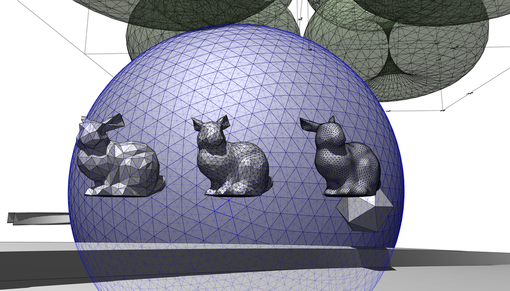

2026-08-27 02:45 AM - edited 2026-08-29 11:35 PM
Subdivided Icosahedron / Geodesic
! ICOSPHERE
IF examples = "icosphere" THEN
!BASE ICOSAHEDRON
phi = (1.0 + SQR(5.0)) / 2 !1.6180339887
nPoints = 12 : nFaces = 20 : nEdges = 60
!POINTS
po_s[1][1] = -1 : po_s[1][2] = phi : po_s[1][3] = 0
po_s[2][1] = 1 : po_s[2][2] = phi : po_s[2][3] = 0
po_s[3][1] = -1 : po_s[3][2] = -phi : po_s[3][3] = 0
po_s[4][1] = 1 : po_s[4][2] = -phi : po_s[4][3] = 0
po_s[5][1] = 0 : po_s[5][2] = -1 : po_s[5][3] = phi
po_s[6][1] = 0 : po_s[6][2] = 1 : po_s[6][3] = phi
po_s[7][1] = 0 : po_s[7][2] = -1 : po_s[7][3] = -phi
po_s[8][1] = 0 : po_s[8][2] = 1 : po_s[8][3] = -phi
po_s[9][1] = phi : po_s[9][2] = 0 : po_s[9][3] = -1
po_s[10][1] = phi : po_s[10][2] = 0 : po_s[10][3] = 1
po_s[11][1] = -phi : po_s[11][2] = 0 : po_s[11][3] = -1
po_s[12][1] = -phi : po_s[12][2] = 0 : po_s[12][3] = 1
!FACES
f_pi[1][1] = 1 : f_pi[1][2] = 12 : f_pi[1][3]= 6
f_pi[2][1] = 1 : f_pi[2][2] = 6 : f_pi[2][3]= 2
f_pi[3][1] = 1 : f_pi[3][2] = 2 : f_pi[3][3]= 8
f_pi[4][1] = 1 : f_pi[4][2] = 8 : f_pi[4][3]= 11
f_pi[5][1] = 1 : f_pi[5][2] = 11 : f_pi[5][3]= 12
f_pi[6][1] = 2 : f_pi[6][2] = 6 : f_pi[6][3]= 10
f_pi[7][1] = 6 : f_pi[7][2] = 12 : f_pi[7][3]= 5
f_pi[8][1] = 12 : f_pi[8][2] = 11 : f_pi[8][3]= 3
f_pi[9][1] = 11 : f_pi[9][2] = 8 : f_pi[9][3]= 7
f_pi[10][1] = 8 : f_pi[10][2] = 2 : f_pi[10][3]= 9
f_pi[11][1] = 4 : f_pi[11][2] = 10 : f_pi[11][3]= 5
f_pi[12][1] = 4 : f_pi[12][2] = 5 : f_pi[12][3]= 3
f_pi[13][1] = 4 : f_pi[13][2] = 3 : f_pi[13][3]= 7
f_pi[14][1] = 4 : f_pi[14][2] = 7 : f_pi[14][3]= 9
f_pi[15][1] = 4 : f_pi[15][2] = 9 : f_pi[15][3]= 10
f_pi[16][1] = 5 : f_pi[16][2] = 10 : f_pi[16][3]= 6
f_pi[17][1] = 3 : f_pi[17][2] = 5 : f_pi[17][3]= 12
f_pi[18][1] = 7 : f_pi[18][2] = 3 : f_pi[18][3]= 11
f_pi[19][1] = 9 : f_pi[19][2] = 7 : f_pi[19][3]= 8
f_pi[20][1] = 10 : f_pi[20][2] = 9 : f_pi[20][3]= 2
!SUBDIVISION
FOR s = 1 TO subdivide
DIM f_pi_temp[][] !faces point index
DIM edge_su[][2] !temp edges for subdivision
DIM po_midkeys[][] !mid keys of points po_midkeys[][1] = count | po_midkeys[][x+1] midpoint indices
DIM mid_indices[] !mid indices
DIM mid_indices_clear[] !mid indices clear
FOR i = 1 to nFaces
mid_indices = mid_indices_clear
edge_su[1][1] = f_pi[i][1] : edge_su[1][2] = f_pi[i][2]
edge_su[2][1] = f_pi[i][2] : edge_su[2][2] = f_pi[i][3]
edge_su[3][1] = f_pi[i][3] : edge_su[3][2] = f_pi[i][1]
FOR j = 1 TO 3
midpoint = 0
!Check if midpoint exists
IF po_midkeys[edge_su[j][1]] [1] # 0 AND po_midkeys[edge_su[j][2]] [1] # 0 THEN
FOR l = 1 TO po_midkeys[edge_su[j][1]] [1]
FOR m = 1 TO po_midkeys[edge_su[j][2]] [1]
IF po_midkeys[edge_su[j][1]][l+1] = po_midkeys[edge_su[j][2]][m+1] THEN
mid_indices[j] = po_midkeys[edge_su[j][2]][m+1]
midpoint = 1
ENDIF
NEXT m
NEXT l
ENDIF
IF midpoint = 0 THEN
nPoints = nPoints + 1
mid_indices[j] = nPoints
po_s[nPoints][1] = (po_s[edge_su[j][1]][1]+po_s[edge_su[j][2]][1])/2
po_s[nPoints][2] = (po_s[edge_su[j][1]][2]+po_s[edge_su[j][2]][2])/2
po_s[nPoints][3] = (po_s[edge_su[j][1]][3]+po_s[edge_su[j][2]][3])/2
countm = po_midkeys[edge_su[j][1]] [1]
countm = countm +1
po_midkeys[edge_su[j][1]] [1] = countm
po_midkeys[edge_su[j][1]] [countm +1] = nPoints
countm = po_midkeys[edge_su[j][2]] [1]
countm = countm +1
po_midkeys[edge_su[j][2]] [1] = countm
po_midkeys[edge_su[j][2]] [countm +1] = nPoints
ENDIF
NEXT j
f_pi_temp[(i-1)*4+1][1] = f_pi[i][1]
f_pi_temp[(i-1)*4+1][2] = mid_indices[1]
f_pi_temp[(i-1)*4+1][3] = mid_indices[3]
f_pi_temp[(i-1)*4+2][1] = f_pi[i][2]
f_pi_temp[(i-1)*4+2][2] = mid_indices[2]
f_pi_temp[(i-1)*4+2][3] = mid_indices[1]
f_pi_temp[(i-1)*4+3][1] = f_pi[i][3]
f_pi_temp[(i-1)*4+3][2] = mid_indices[3]
f_pi_temp[(i-1)*4+3][3] = mid_indices[2]
f_pi_temp[(i-1)*4+4][1] = mid_indices[1]
f_pi_temp[(i-1)*4+4][2] = mid_indices[2]
f_pi_temp[(i-1)*4+4][3] = mid_indices[3]
NEXT i
f_pi = f_pi_temp
GOSUB "metrics_calc"
next s
FOR i = 1 TO nPoints
vec_temp[1] = po_s[i]
GOSUB "V_Aunit":
po_s[i] = vec_out[1]
po_s[i][1] = po_s[i][1]*p_ru
po_s[i][2] = po_s[i][2]*p_ru
po_s[i][3] = po_s[i][3]*p_ru
NEXT i
GOSUB "BB_calc"
ENDIF
3 weeks ago
Loop subdivision, having some fun with chatgpt
a week ago
With some help from chatgpt:
Friday
Low poly bunny with 4 loop subdivision iterations.
124000 triangles.
Does not use PROJECT2
Working on a projection routine that is optimized for larger meshes, already a big speed improvement.
