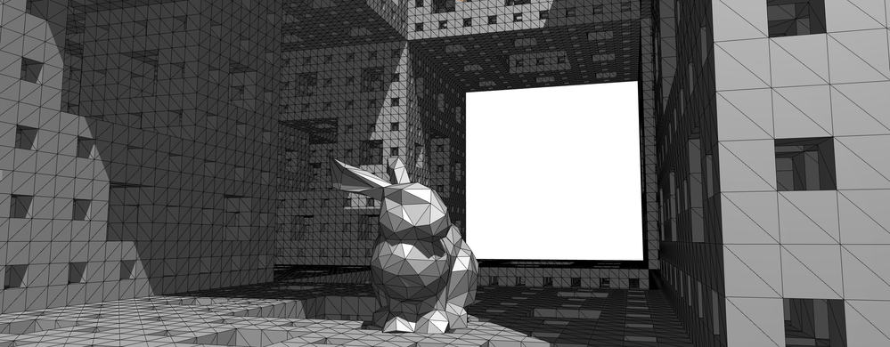

*) Monkey read from text-file
*) Arbitary rotation around an axis rodriques transformation
*) Display Helper Axes

2 weeks ago
Loop subdivision, having some fun with chatgpt
yesterday
With some help from chatgpt:
