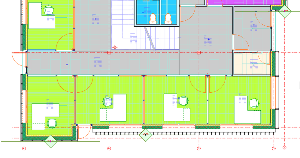

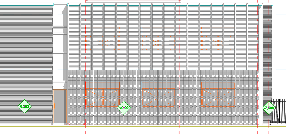

You can see in the attached image how i manually insert Facade depth marks,
actually nothing can achieve this automatically inside archicad , unless you model a base wall, and add a clumn in frn of it , and label the column depth to get the right value automatically,
this technique isn't always useful,
I'm thinking about a GDL object, drawn in plan between the 2 levels, it's like an invisible succession of planes that can be adjusted in plan, we set the first plan on the referance surface, all other plans can be adjusted in plan and detected by a label in elevations,
Can this be done in GDL ?
Thanks.

In elevation, the exterior face of the main wall is considered as a reference,  it has 0 cm depth,
U have to mension the distance from that face to Any adjacent volume,
In the attached images, on plan the difference between outside faces the big straight wall and the small volume ob the left is 37,
This dimension is also mentionned on the elevation  + 37

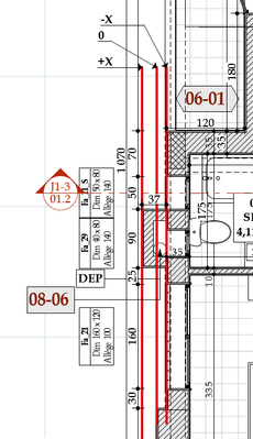

Hello @Ahmed_K ,
I just made an object that may give you some ideas, it's a quick effort but it's juste a be a proof of concept. It's not a proper symbol as that subtype doesn't allow scripting in 3D, it's a generic documentation element.
Basically, you set the origin point of the object (that would be the ±0.00) in plan view and then there are two "planes", a back one and a front one that are movable for the depths and lateral position. In elevation, it's possible to move the marks laterally and vertically.
To note, the object is only visible in plan views, sections and elevations and was made in Archicad 24.

Thanks @MF BIM for your reply and for sharing the object !!
I just tested it and it works fine , the concept of showing object's own dimensions is great,
i'm noobie in GDL, i just opened the object to discover the logic behind it, actually it can be tweaked to add multiple levels upward and backward, changing the text box appearance , font type, font size, measurement unit,
I will try and share the result here  😀
