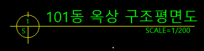

I'm trying to get the GLOB_STRUCTURE_DISPLAY value from title. What should I do?

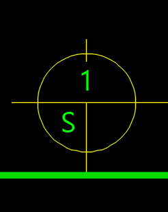

S is a structural drawing.
A is an architectural drawing.
I'm trying to read this function to distinguish it.
Is there a function at the top that can be read even once?
Number 1 is the drawing number entered into this layout.
In Revit it is sorted automatically.
AC27 on window 11

From your picture, it seems that you want to obtain the name of the drawing or layout.
SO, you can take a look here to see if there is anything you want.
