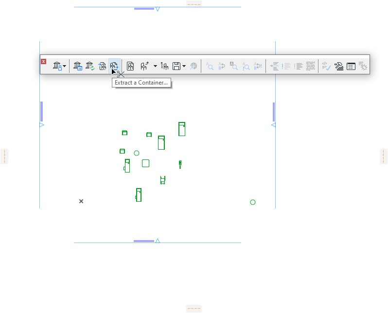

1.Use the GDL object editing toolbar to extract the ArchiCAD object library and the surface library.
The option to extract the container is indicated.
This option will extract the content to a dedicated folder

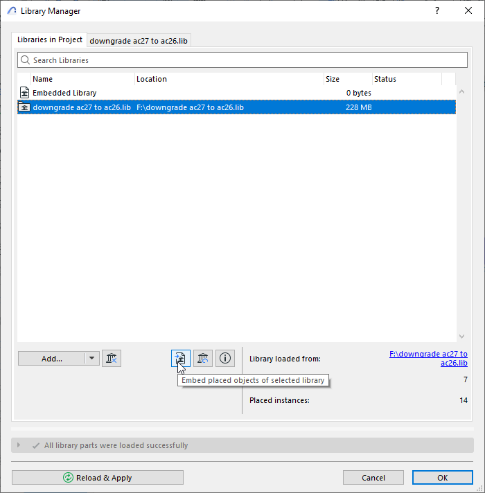

2.With the library manager Change the LCF file of the objects and surfaces with the folders where you extracted the content
3.Now the objects will be read from these folders.
Ok, then save your file in PLA file format
4.Open your PLA file and use the Extract the objects to a library folder option.
5. Once the file is open, go to the library manager - select the library folder and use the Embed the objects option
Now all the objects in the folder will be in the embedded library.
