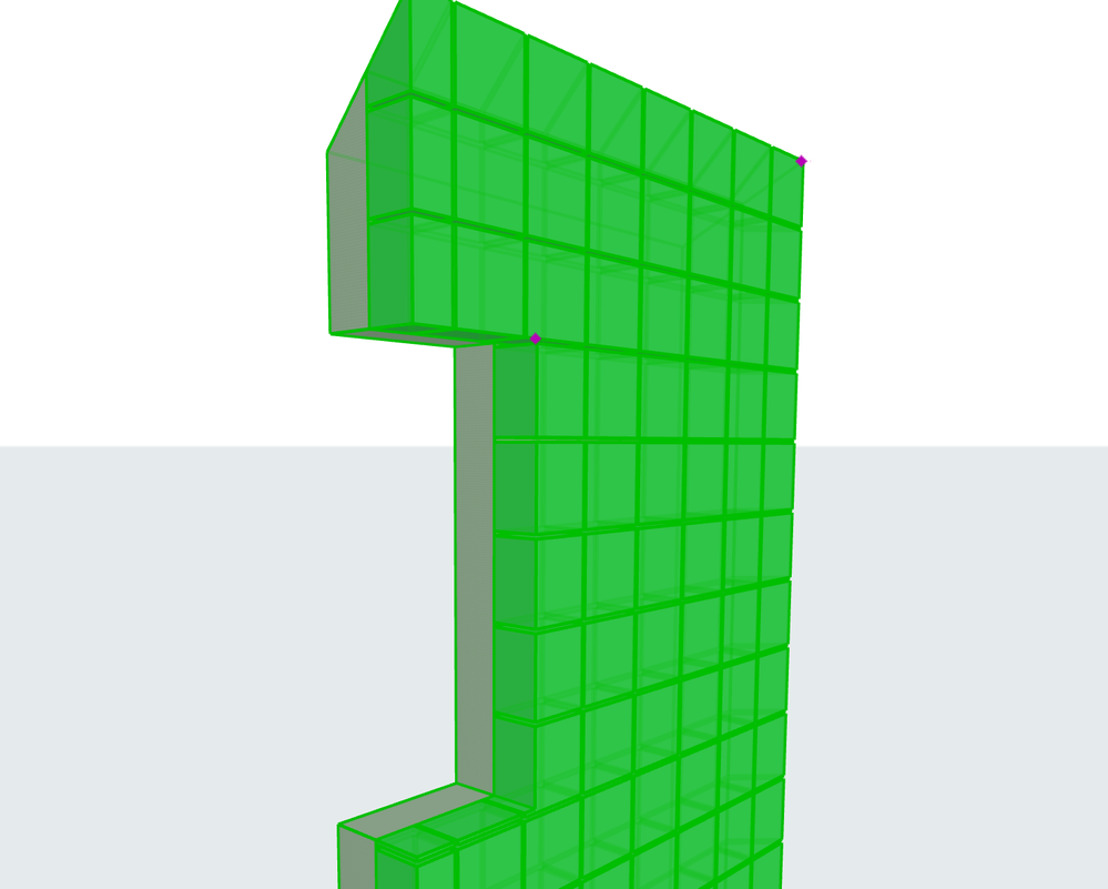

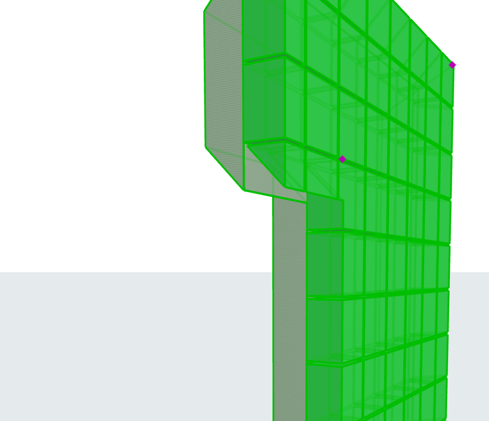

How can I add 45-degree chamfer hotspots on all four sides of this opening without recessing? Is the
I want to make a 45-degree bevel at this opening. Which command should I use? I have been experimenting for several days, but I can't make it the same on all four sides. Is my direction wrong?

Peter Baksa
your title and code looks fragmented too, I can't decode what is the exact problem.
Looking at the pictures you might have a transformation problem, try to debug your cutplanes' orientation withlin_
Another approach could be building a non-infinite cutting body fromCUTFORMs.
