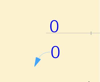

How can I get the zone name from label gdl?

LeeJaeYoung
thank you
But when I do this, it doesn't link with the zone
n = 0, so no value appears.
It would be really appreciated if you could tell me the function for linking in the label.
AC27 on window 11
LeeJaeYoung
I found out while testing that the zone label 25 and zone could not be linked with the label tool.
Up to this point, I forgot to link with the label created when creating the zone.
thank you ^^

LeeJaeYoung
see ac25 built-in parameters
: how can i see it?
propertyValues
: DIM propertyValues?, propertyValues[]??,propertyValues[]??
  Which one?
text2 0,0,propertyValues
:  Is it possible?   I can't do it now.   What should I study?

Peter Baksa
Property_Value_Of_Parent always returns a one-dimensional array. It also returns the array size dim1 and dim2. You have to interpret the array accordingly.
dim1 = 0, dim2 = 0: simple, scalar value at array[1]
As far as I know, property values can't be two-dimensional.
